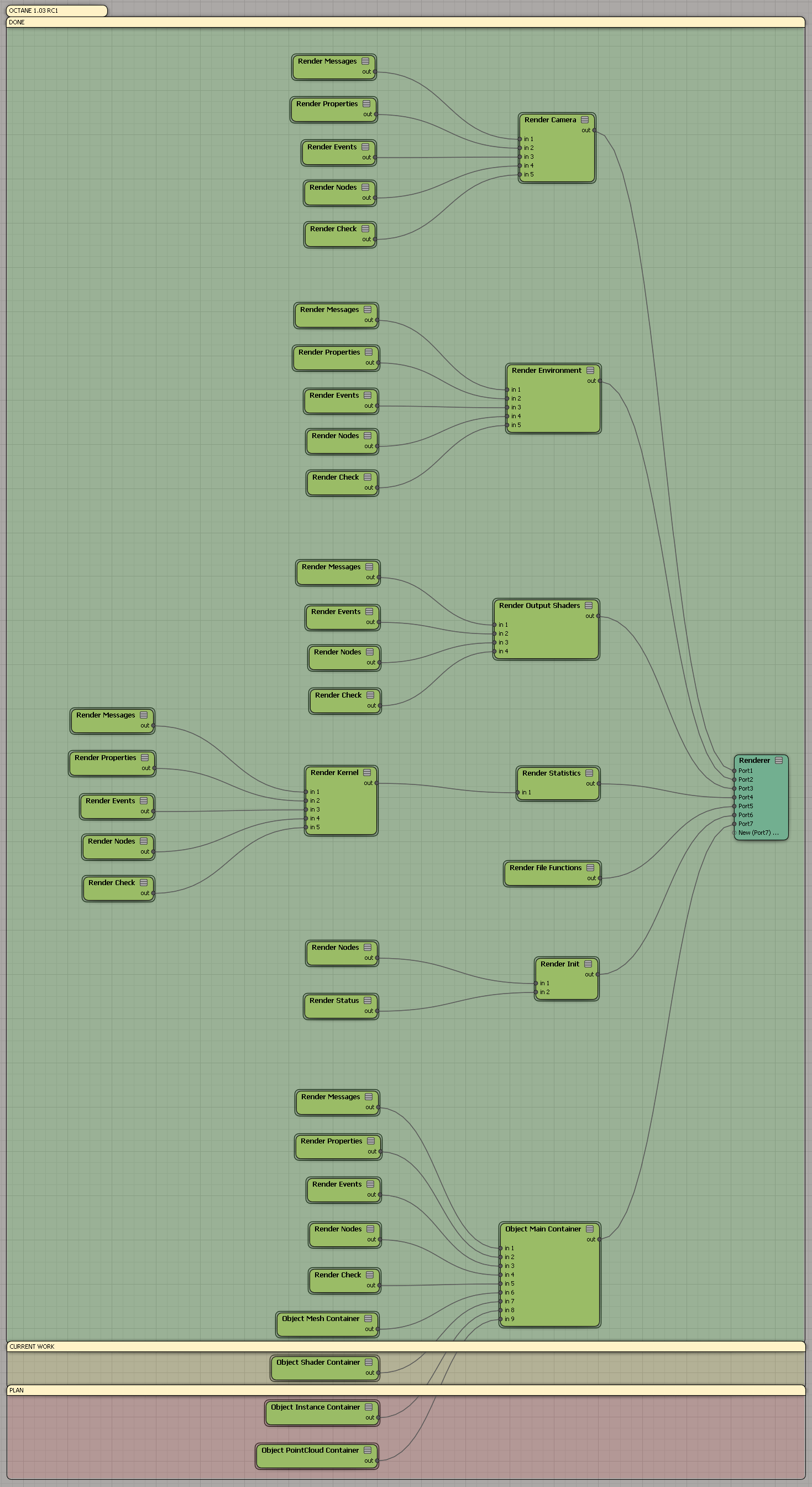

Postby face » Wed Mar 11, 2015 10:24 pm
face Wed Mar 11, 2015 10:24 pm
Sorry for the long pause.
I will only make a quick report of the current work.
Have switched to the VS2013 IDE.
In the attached image, you can see the plugin flow and the current status.
When the shader container is done, i will release a 1.03 RC1.
After some bugfixes, i think there will be some, i will include the instances again, which shouldn´t take much time.
At last, ICE will be integrated. I don´t know if i should also include strands because they need much speed to calculate and will create heavy meshes.
