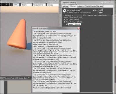

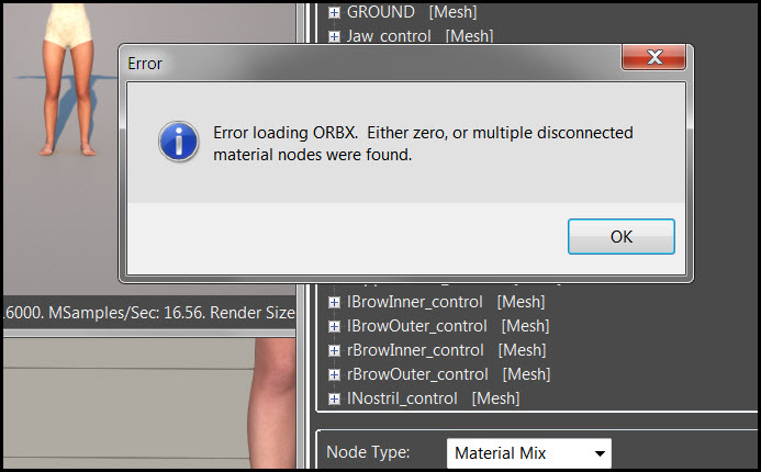

[*]Bug 1 - Octane Poser fails to load (see pic2) at least half of unedited-download orbx as well as custom orbx
If I load the same unedited material directly from Livedb, O4P will load it!
Also a text report popup after certain Livedb/Localdb material loading fail (pic1 may show clues)
[*]Bug 2 - Octane will not remember new Localdb location
always revert to Appdata/Roaming/OctaneRener/ localdb folder
so for now I can't use Localdb to store custom materials
This happens after multiple exit reopen Poser and using either Pauline Torso or a simple primitive.
Have also 'cleared all data.'
Also notice there are no Thumbnail or visual indicator for imported Octane material in the form of orbx or poe
Is that a bug too or a work in progress?
Thanks.

Set up a custom Localdb at (non-system) content drive today
Octane standalone remembers Localdb location, reads and renders downloaded/custom orbx in Localdb
But
Yes, the plugin assumes the Octane Standalone LocalDb is located at C:\Users\[username]\AppData\Roaming\OctaneRender\localDb, and moving it will mean you need to manually direct the OpenFile dialog to the correct location. I will add this to the list to fix, however it is low priority, so may take a while, sorry.
Paul
