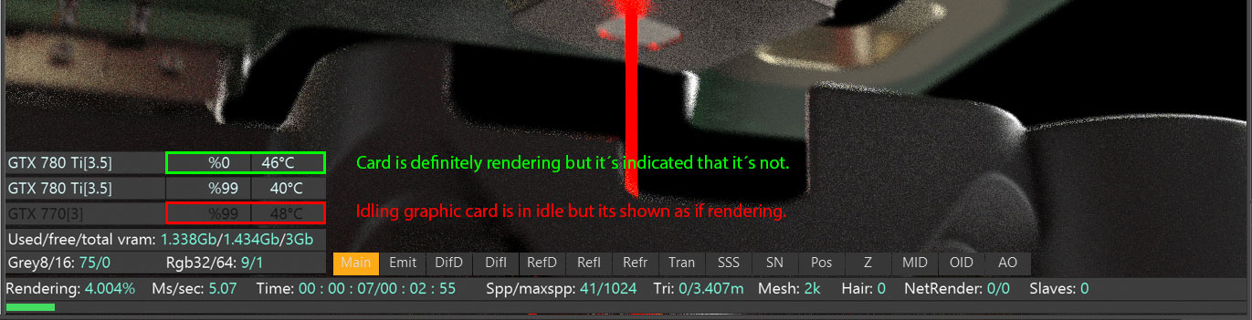

Silverwing
Posts: 291
Joined: Wed Jun 15, 2011 8:36 pm
Location: Ludwigsburg Germany
Hi Ahmet.
Thanks for your great work. I really appreciate what you are doing and the growing of Octane!
I just want to 2nd what was said before about the disappearing render stats at the end of the rendering.
It yould be nice if the stats would not disapear in the live viewer at the end of the rendering.
As user you can deciede wether to toggle them on and off. Even after rendering stops.
Also I noticed a strange behaviour at the GPU stats.
They seem to be switched.
I have 3 cards in my system. and I have turned off the card connected to my display in the octane settings.
This card however "grayed out" is shown as it is actuve.
Maybe this is just a small mix up of data...
Here´s a pictue:
Thanks for your hard work and keep on rocking!
Cheers,
Raphael
WIN 11 PRO 64 | ASUS X299 SAGE | 1X RTX 4090 3X RTX 3090 | i7 10980XE | 128GB RAM

Silverwing wrote:Hi Ahmet.
Here´s a pictue:
Cheers,
Raphael
Hi Raphael,
there is a parameter in settings->other->keep stats. This will keep infos always on. For gpu infos, there is a matching problem between CUDA and Nvidia api. On some setups, it doesn't match the order of gpus. No way to fix it on my side.
