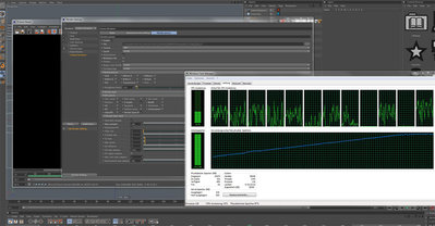

I think i have an issue with the new feature render layer.
It works so fine so far. But i think there is an memory issue.
I have enabled 4 Ids to render. The rendering is fine but after each rendered frame - my ram memory gets more and more loaded.
After the ram is full c4d crash. This happen only when render layer id is enabled.
I'm working on Windows 7/C4D R15/ Octane2.20.
I'll send u the scene file to check.
Cu
Pommbaer

ok thanks. I'll fix if there is a error. Soon i'm going to release 2.21 with new features and better node editor.Pixelkingdom wrote:Hi aoktar!

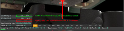

Also I noticed a strange behaviour at the GPU stats.
They seem to be switched.
I have 3 cards in my system. and I have turned off the card connected to my display in the octane settings.
This card however "grayed out" is shown as it is actuve.
Maybe this is just a small mix up of data...
Here´s a pictue:
Here´s a pictue:

Hi Raphael,Silverwing wrote:Hi Ahmet.
Thanks for your great work. I really appreciate what you are doing and the growing of Octane!
I just want to 2nd what was said before about the disappearing render stats at the end of the rendering.
It yould be nice if the stats would not disapear in the live viewer at the end of the rendering.
As user you can deciede wether to toggle them on and off. Even after rendering stops.
Here´s a pictue:
Thanks for your hard work and keep on rocking!
Cheers,
Raphael
there is a parameter in settings->other->keep stats. This will keep infos always on. For gpu infos, there is a matching problem between CUDA and Nvidia api. On some setups, it doesn't match the order of gpus. No way to fix it on my side.
