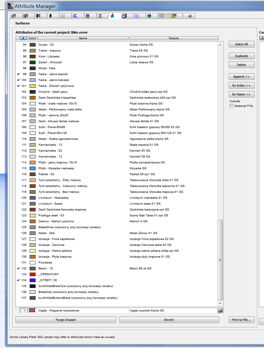

Joined: Tue Nov 11, 2014 2:57 pm
face_off wrote:
Also Marek - the scene you sent appears to have over 600 materials - which is taking a long time on my system to cache in stage 1. I suggest trying to reduce the Surfaces list to something more manageable.
Paul
And how would you do that?
By that?:
I did that and file size decreased to about 3,4 GB, but before and after I have only 137 Surfaces listed in Attribute Manager:
So where is the list of 600 Surfaces to be reduced, please?
