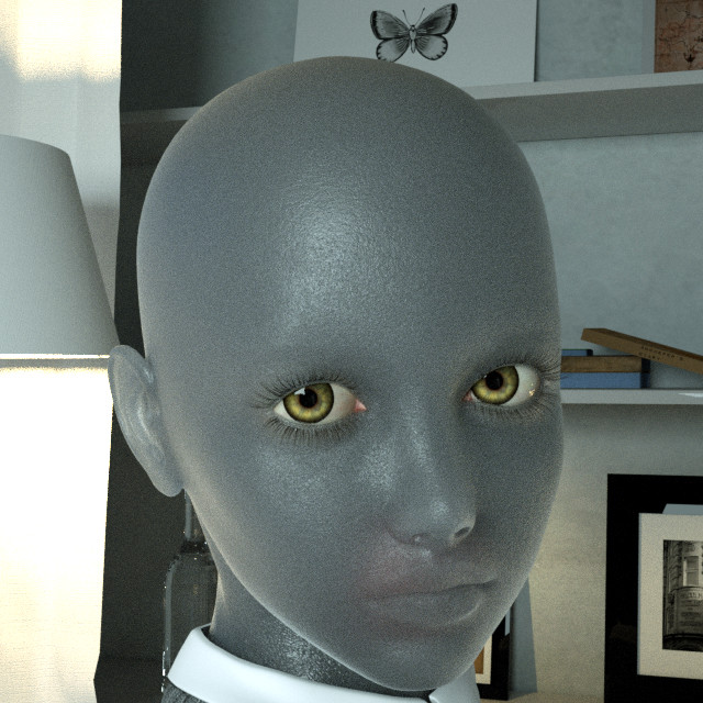

sikotik13: I really appreciate your comments. I'm just trying to learn how to do this better. And I can only stare at strangers in malls so much to learn about skin.
linvanchene: I had assumed as much and was concentrating on the ears for seeing the effects of translucence.

So I ran some more experiments to see if there was something else I liked. Based on the Ordiales shader, I set the transmission and scattering to an RGB color, and I set the absorption to grey scale .1, and scattering to 0.
I tested RGB White (produces cold results), RGB off Red which produces darker blood red colors, and RGB SSS. (Teen Josie has a default SSS colour in its textures so I grabbed that.)
It was fun seeing nearly see through stuff, and I did once make the mistake of not setting the back of the head which produced an interesting geletinous looking creature with see through bits.
Notice the light through the ear. Near as I can tell that material is very thin with this model.
Its no surprise, but I'm liking the SSS flavor.

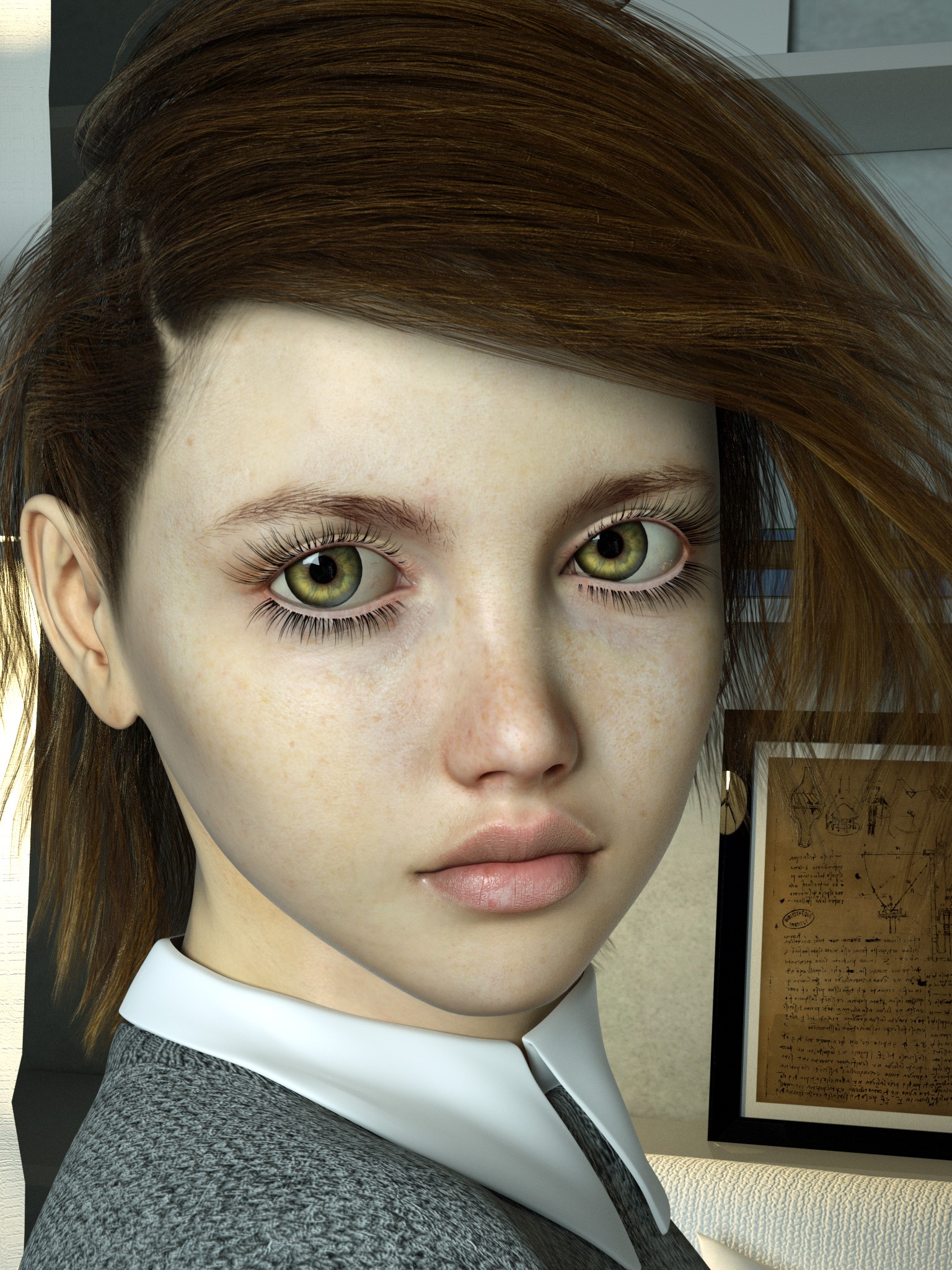

Anyways I 'was' planning to increase the Bump before posting, but I think you'll like this render. Its iPad 3 scale.
