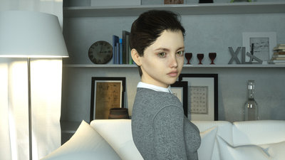

I just purchased the new 2.x plugin for Daz, and am really confused on how to properly implement material from Live DB.
I am specifically trying to use "icelaglace's SSS skin 1.0" with a Victoria 6 HD model.

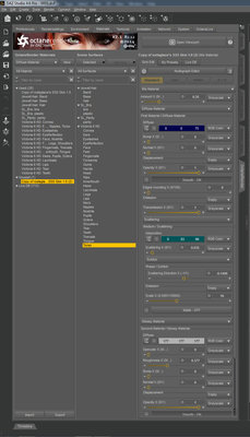

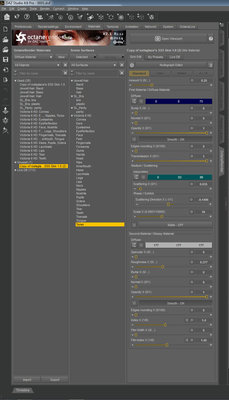

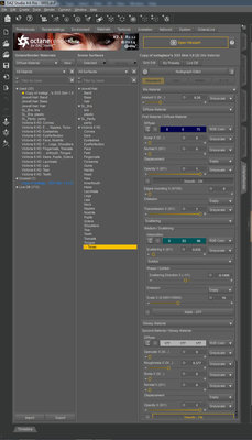

When I copy in the material in, I am met with these options (see screenshot 01), after hitting the small button next to the 'nodegraph editor' I am met with more options (see screenshot 02).
After playing around with it a little, I am still confused which properties from screenshot 2 do I change, and have them linked as either a floatimage, RGB image, or whatever it is called now to the proper color, bump, and specular maps.

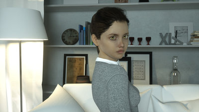

These are some of the results that I get with the settings:
Any help, pointers, or steps would be VERY appreciated. I am fairly new to Octane, and very new to this plugin.
Thanks!

Looking at the material in standalone, most of the stuff you want to replace is in the 'Second Material / Glossy Material', put a skin texture in a RGB color map in diffuse and the spec and bump maps in grey maps in specular and bump (you'll also need to change the power setting of both the spec and bump depending on how they turn out, but as a guess I'd set spec power between to 0.7-1.0 and bump between 0.05-0.075).
In the 'First Materials' I'd change Scale under 'Medium / Scattering' from 10 to at least a 100 (this will probably need to be further tweaked), other than that I'd leave the rest as they are for the moment.
This is all very basic to get you up and running with a result that should at least look OK, though I've never used this material so I'm unsure what can be done with it. Once you've done this much change around some of the settings and see/learn what they do, with roughness in the 2nd material being another important one to look at, as it controls how glossy/wet the skin will look if you wish the change that.

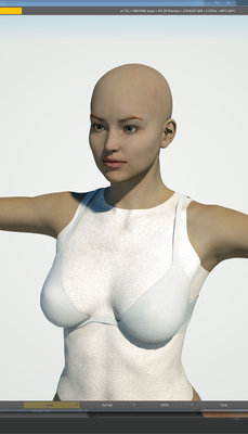

Using the Daz plugin, I ran the same scene with three different skin shaders. The original skin is Teen Josie 6, which has a fair amount of pink added to its diffuse light. I added a the same tint only much less saturated.
http://www.daz3d.com/teen-josie-6
Still I can't figure out why Ordiales' shader was so brown looking. Even as I built up the shader, the results looked very similar to Ordiales example. However, the final 40% mix looks strikingly different. I guess I fear that if I reduce the non-diffuse component, I'll get less specular, which I think is correct with Ordiales' shader.

Taking a wild stab based on the thread instructions, I would guess the brownness is from your specular reflection/scattering rgb values. The intention and effect of those exact settings in the thread was to add more of a brown undertone, you may want to adjust them if you are going for a brighter or alternate undertone. I don't think the scaling referenced later on would have an effect, since I think that's mostly due to the way TonySculptor's skin is set up, not the OP's. Undertones are highly scene/light/creator(you) and texture dependent, hence the no magic answer thing. I personally think it looks the least washed out, but should be perhaps lightened a little (undertone wise), and perhaps the green scattering value reduced a little, but that's just guessing and oriented to my tastes.
