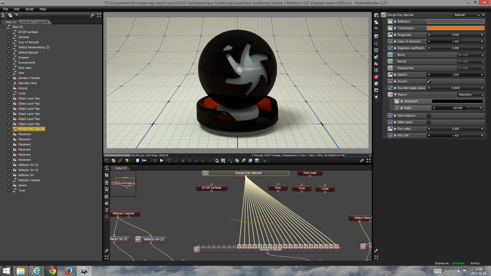

Octane Standalone doesn't allow selection of multiple pins. We realized that making or breaking connections one-by-one is tedious so we will introduce multi-connect and disconnect in version 2.21.
2.21 will ship very soon so say tuned.

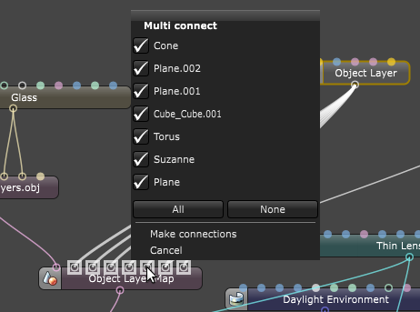

The window with the checkmarks looks like a very comfortable way to adjust pin connections.stratified wrote:Hi,
cheers,
Thomas
Thomas, thank you for sharing this great news!
Update/Edit:
This was indeed very soon.
The OctaneRender Standalone 2.21 Development Build is released:
http://render.otoy.com/forum/viewtopic.php?f=33&t=44704
Click on ALL first if you intend to use most connections and uncheck those few you do not want.[*] Added multi-connect feature, which is activated when you hold down the CTRL key (CMD key on OSX) while connecting a node with another. If only one connection is possible, this feature is inactive.
Click on NONE first if you only want to check a few connections.
Hit MAKE CONNECTIONS to commit to your choices.
- - -[*] Added connection "cutter" that kicks in if you hold down the CTRL key and draw a line over the connection to remove.
The "Multi Connect" window and the "Cutter" are indeed very helpful tools to adjust pin connections in a very efficient way.
