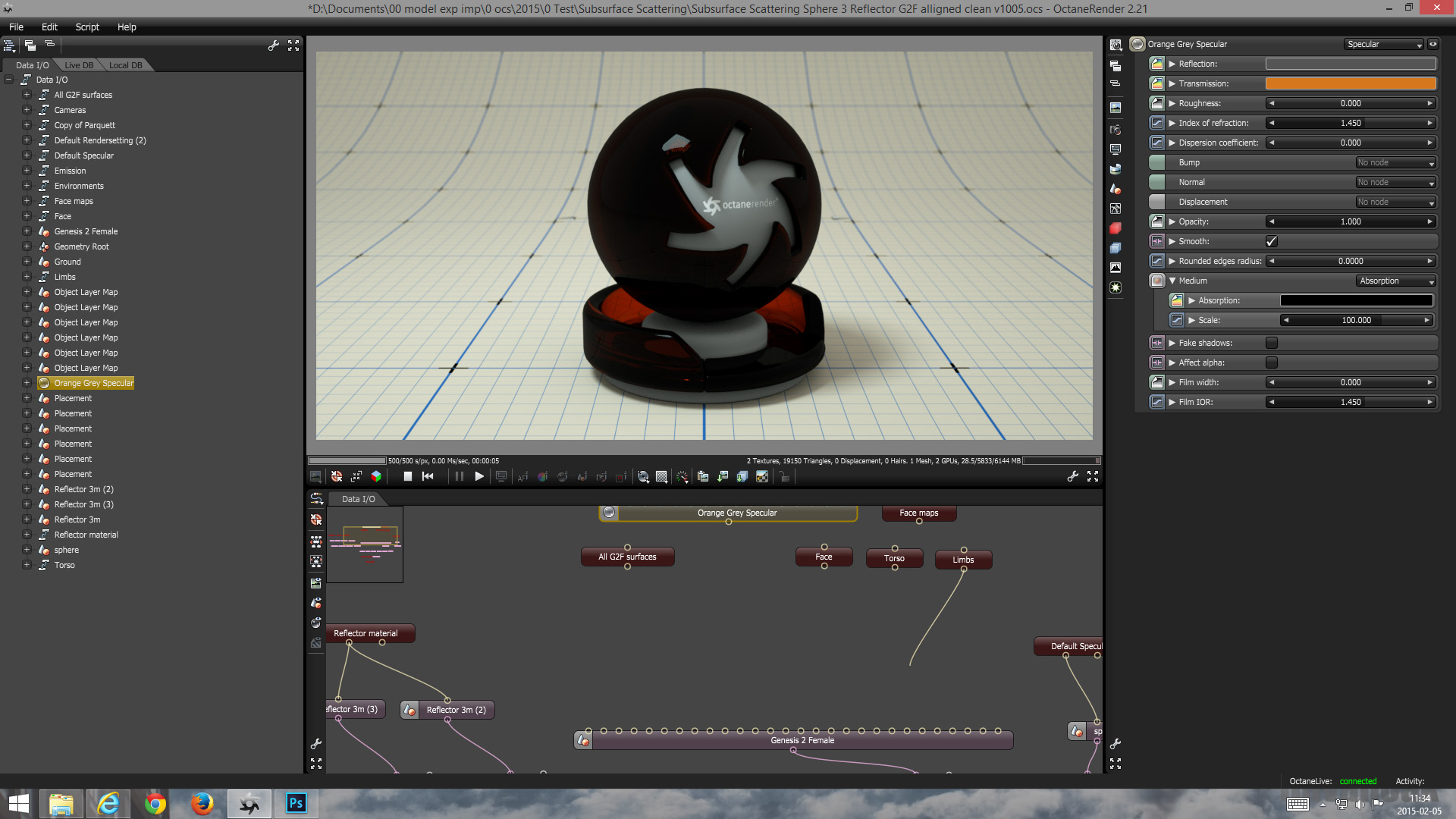

[*] Added multi-connect feature, which is activated when you hold down the CTRL key (CMD key on OSX) while connecting a node with another. If only one connection is possible, this feature is inactive.
Hold CTRL while dragging from an OUT pin to an IN pin with multiple possible connections

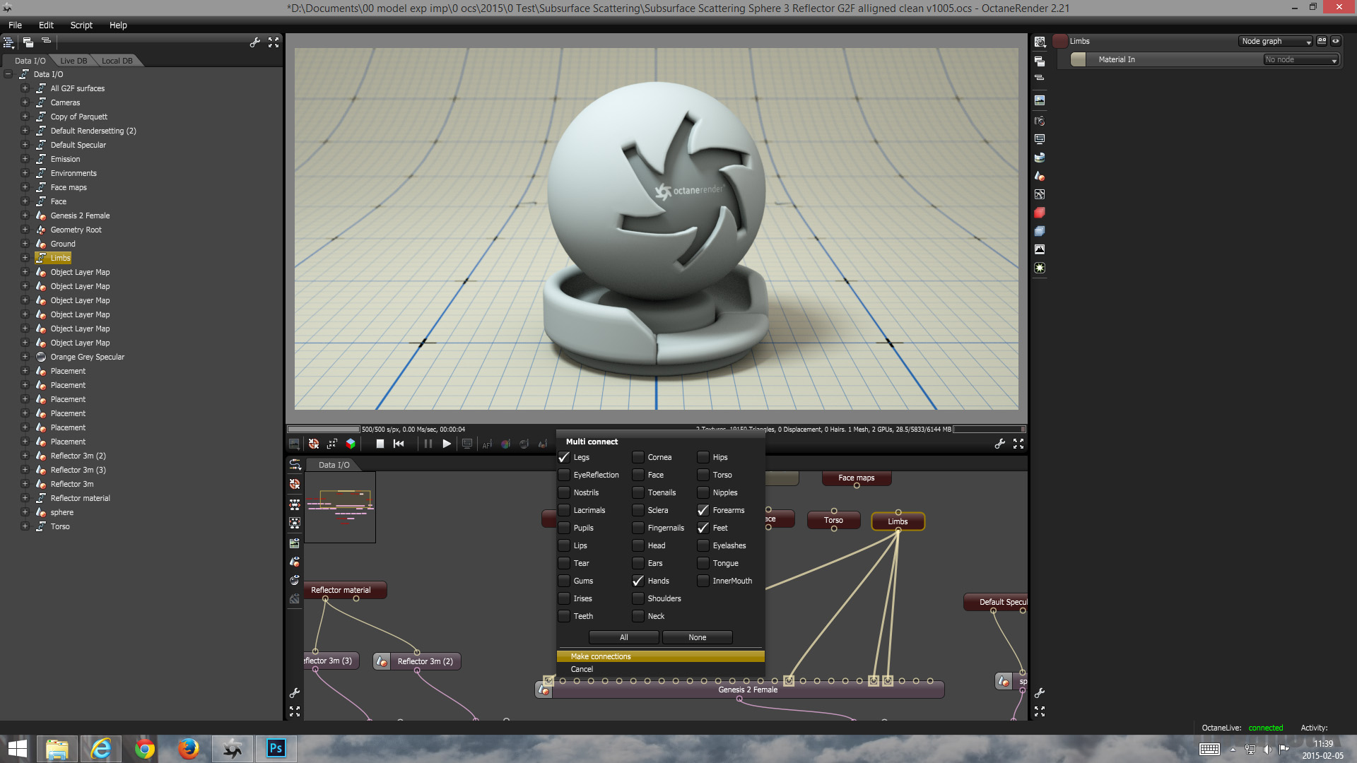

Multi Connector options
Click on ALL first if you intend to use most connections and uncheck those few you do not want.
Click on NONE first if you only want to check a few connections.
Hit MAKE CONNECTIONS to commit to your choices.
