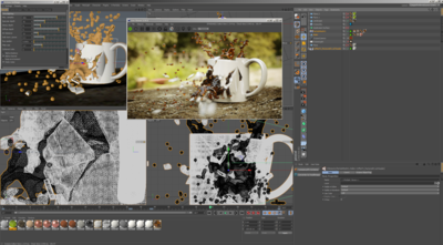

My dilemma - I have a scene file of a coffee cup mesh (.SD animation file) being fractured by a bullet (made in C4D) as well as a liquid particle mesh (.bin sequence) out of RealFlow 2014. When I add the Octane Tag and turn on motion blur to the objects in my scene, the cup mesh and bullet display motion blur properly but I can't seem to get the liquids to render motion blur, even if I turn up the Particle Mesh objects frame sample rate and/or Octane's motion blur settings. See screenshot below. Any insight would be helpful.

octane can't supports motion blur for nonconstant vertex amounts. you can try but will give wrong mblur.
