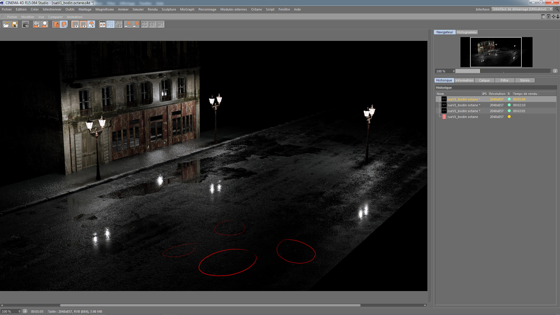

I need to know if it's possible to reduce the noise like in the image (white point) without using a lot of samples like 16000 samples.
I don't want to explose my render times.

try gi_clamp < 10 values.

i am in directlighting so, i don't have this option.
But i have reduce the "glossy depht" to 1 and the noise disappear faster.
but some glossy materials disappear too :)

PT is faster than diffuse on many scenario with latest updates.
