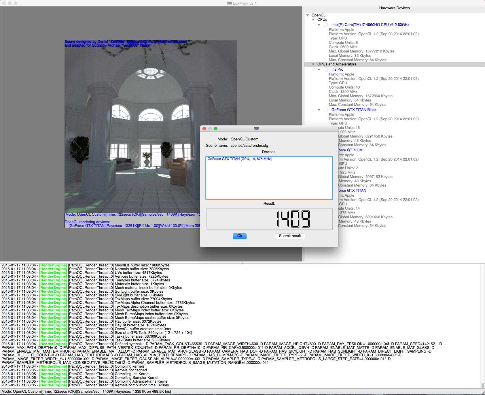

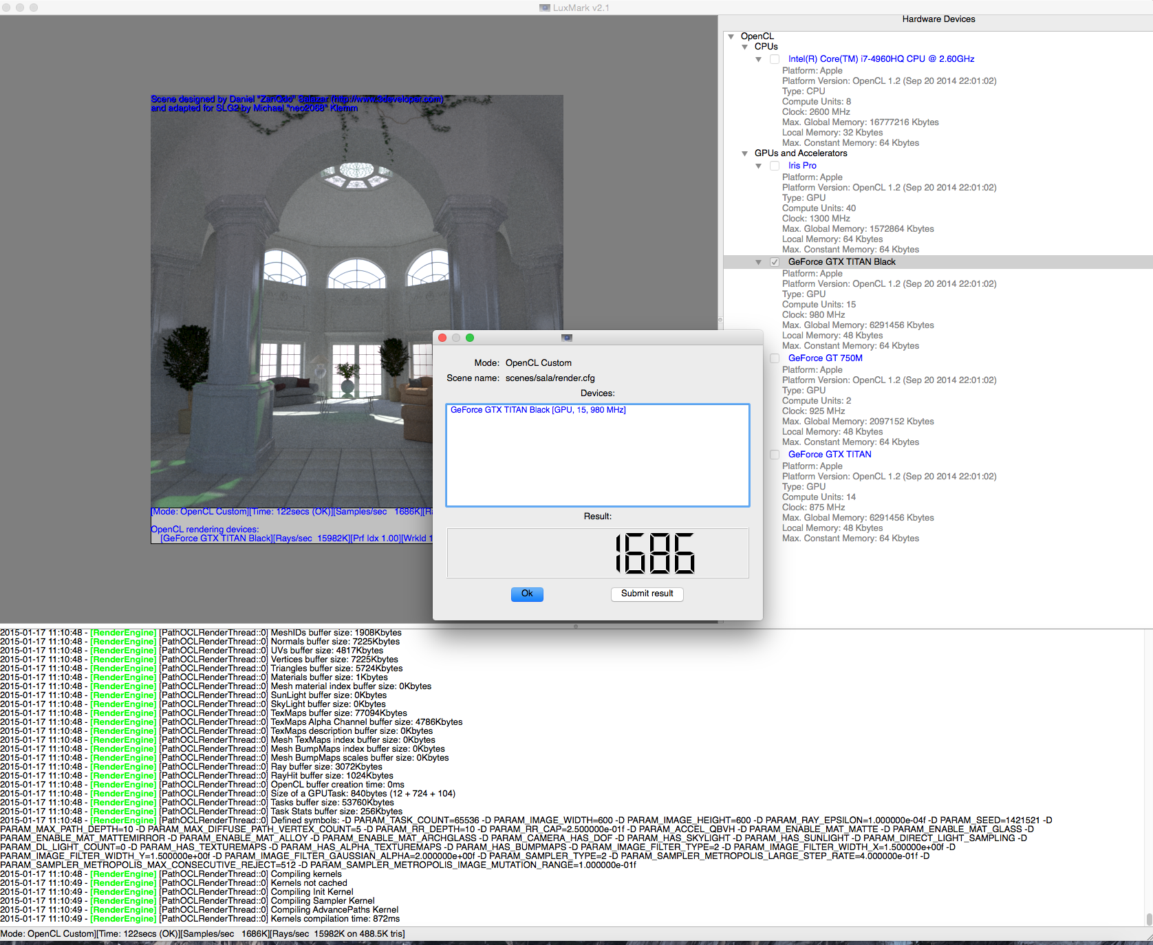

A little update on my latest setup. I decided to add a Titan Black instead of a Titan Z because I got a Black for $600 on eBay bran new. I've got a TITAN Black + a TITAN running on 2 Akitio enclosures daisy chained. I modified this case to hold the kit too. It's not a perfect modification but if anyone is interested, I can post some pics that show the process to modify it which was pretty simple. Here are some benchmarks as well. My tests reflect Jose's finding that daisy chaining doesn't seem to bottleneck rendering one bit. I think if I add another to this, it'll probably be a Titan Z because I'm sure 4 daisy chains would have an effect.
As for a Titan Black or a Titan Z, they both seem to work but the double GPUs can be a little more of a hassle to setup and seem to absolutely require a powered riser. I think the powered riser is a good idea anyhow. I get slightly better benchmarks with a powered riser than I do plugging straight into the Akitio. I don't understand what the cards from macvidcards.com have that others don't. I would just get a regular one if I was you.
Jose's LuxMark Sala benchmark with 2x Titan Zs was 4400. My benchmark with 1x TITAN Black + 1x Titan is 3000. This seems to basically reflect the performance of the cards though. The Titan Z seems to be equal to about 1.5 TITAN Blacks in most rendering situations. Price wise, it seems these cards have varying prices depending on where you buy and you'll wanna add $200 per card for the cost of the Akitio.
TITAN Black Only
TITAN Black Only
Daisy Chained TITAN Only
TITAN Black + Daisy Chained TITAN

Through some tests, I have discovered a nice surprise that seems to have been overlooked here. If you are using regular TITAN cards (not Black or Z) there is no need to install the Nvidia Web Drivers. In fact, the regular TITAN runs about 5% better on the OS X Default Graphics Drivers. This is a great help because it eliminates the need to modify the driver or wonder if you have the best one installed. This simplifies the process of using eGPUs. Also, this works with daisy chaining. To anyone running eGPU setups and having issues, I recommend ditching TITAN Blacks or TITAN Zs and just running regular TITANs on the default OS X drivers.

Also, I did some playing around with different daisy chain configurations and oddly enough, daisy chaining is actually the best way to connect 2 TITAN eGPUs. If I run them parallel into each TB2 port, the benchmarks go down by about 7-8%. My estimate is that until you reach about 3.5 TITANS on a daisy chain, there is no bottleneck. Between my LuxMark scores and Jose's, it seems that about 4500 in the Sala scene is the bottleneck for LuxMark eGPU TB2 rendering. I think Jose's triple TITAN Z daisy chain was a bit much but 2x TITAN Zs would be efficient. This is all figured by using LuxMark so it's based on OpenCL, not CUDA but I think the two are very comparable in this context.
