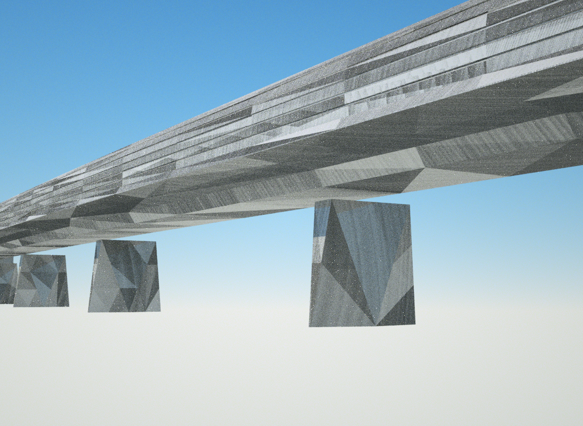

I have a problem on a scene.
I modeled the bridge in Rhinoceros and imported it into Modo - something that's never an issue. But now my render in octane looks like the attached image.
Any suggestions? The native modo render handles it fine.

try adjusting the rayepsilon value
ur scene might be too big or small

Yes - certainly a ray epsilon issue. Rhino offers a vast range of modelling sizes, so it's possible that bridge is a few mm's high or might be a few km's high - so adjust the ray epsilon to suit.
