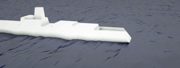

Hi Paul,
I'm still running tests using Bongo and Octane. I was attempting to animate waves, using a Rhino material, since I know OCtane materials can't be animated. I downloaded the file at the link below to test and a single frame will render in the Octane Window, and also in the Rhino Window when I manually click "render". However, upon trying to render out the animation, Rhino locks up if Octane is the render engine. Works fine with Rhino as the render engine however. This seems strange since I can render out a single frame in the Rhino window while Octane is selected as the render engine. It only seems to lock up when trying to render out the animation sequence. I'm on Rhino SR10 (I know SR9 had some issues). Is this an Octane issue, or do I need to hit up the folks in the Bongo Forum?
Bongo Waves Animation: http://bongo.rhino3d.com/video/waves-an ... hino-5-0-1
Thanks,
Ryan
Win10x64 / AMD Ryzen 9 5900X / 64g RAM / 2 x RTX 3090
face_off
Posts: 15718
Location: Adelaide, Australia
Hi Ryan
I loaded that scene and exported to Octane Standalone (via the Export Bongo Animation) menu item. Then rendered in Standalone, and it worked nicely (see below).
I was able to get it to render via the Bongo animation render screen if I flipped the Perspective window into Rendered view first. But it was very slow - because Rhino takes about a minute per frame to calculate the displacement vertices, and Octane takes a long time to process the large amount of displaced vertices from this process
So in summary - go via Standalone for something like this.
