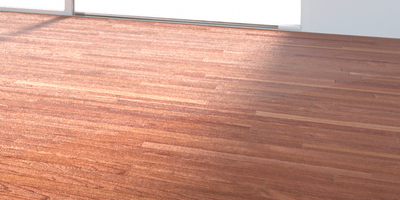

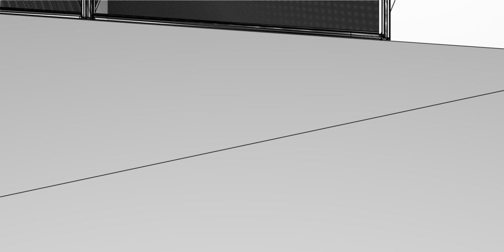

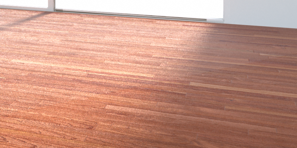

Hi Paul, i've found a bug when try to attack the displacement node..
i'm not sure if is a rhino plugin bug o an general bug of the 2.0 version.
The surface is flat but when I attach the displacement node you see a line that crosses the plane.
With the other materials it's all ok..
Thanx! :mrgreen:
If i select BOX in the projection option, the problem disappears....
You need to adjust the "rayepsilon". Pls refer to http://render.otoy.com/manuals/Rhino/?page_id=650.

i try it, but there is the problem yet...
Is there a reason you are applying a displacement map to a flat floor? What are you trying to achieve in this case pls?
Paul

I would add a more realistic effect to the wood map, in this case I could do without it but I have other models in which there are wood counters in a particular way and quieted function would help me a lot for the final rendering ..
What displacement map are you using in the case where you have the issue pls? Is it all one colour? And did you try a ray epsilon of 0?

I would add a more realistic effect to the wood map, in this case I could do without it but I have other models in which there are What displacement map are you using in the case where you have the issue pls? Is it all one colour? And did you try a ray epsilon of 0?
Paul
Rayepsilon to 0 don't work..the map is a black and white png...
