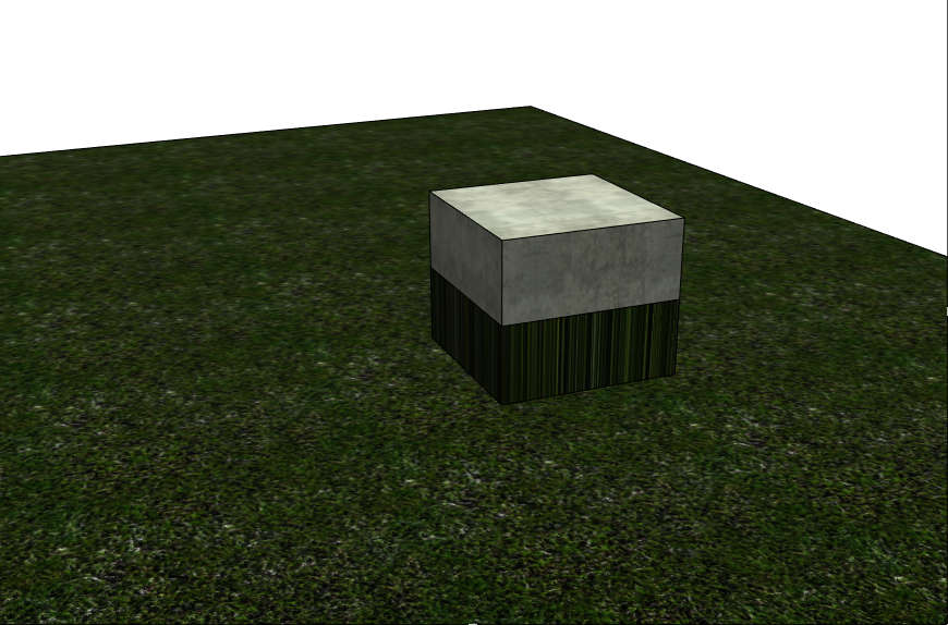

Still about the second example of the previous post, I found this:
This is how an elevated (above ground by offset) building pad looks like in Revit

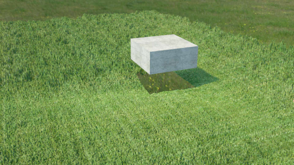

and this is how the same scene looks rendered. The way this algorithm works could be related to the issue with the displacement rendering.

The only subdivision config I found (v2.06) is under the "preferences > geometry import"
You need to use 2.16 - since there have been displacement mapping fixes applied after 2.06.

Thank you Paul,
Now that's beautiful - I got perfect results with 2.16 on my specific scene (another one) with 0.02 height of the grass. Just waiting for this to happen inside the Revit plugin.
