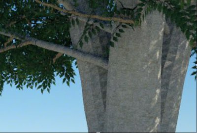

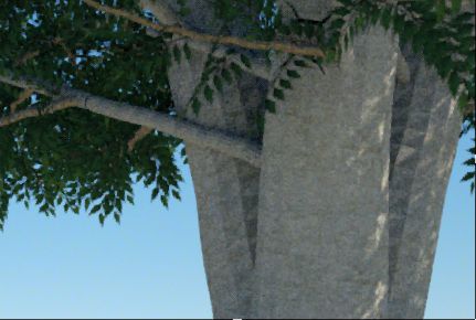

Strange artifact on this tree - I opened this obj (Xfrog eu46) into Max and cannot get this artifact there.
This might potentially be a ray epsilon issue (since the prop will be a different scale in Revit than 3ds max). Does adjusting the ray epsilon fix it? If not, can you pls email me the OBJ file.
