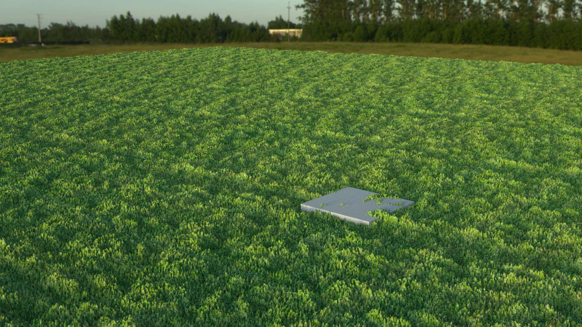

I will show the issue below:
> Toposurface material displacement is okay around an object, in this case is a floor piece.
> Toposurface material displacement is not available around the building pad, but appears far away from it.

Andre,
Usually, there is some level difference between a pad and an undulating site (and all sites are undulating to some degree or another). What confused me about your post is that there seemed not be any level difference between the two, so it was hard to distinguish between the site and pad.
Are you sure your site and pad materials either have the same displacement setting or, alternatively, have exactly the same material applied? Paul, did you check that?
Below is an image of a pad on a site with exactly the same material on both. I have not had any issues with displacement disappearing on pads.
