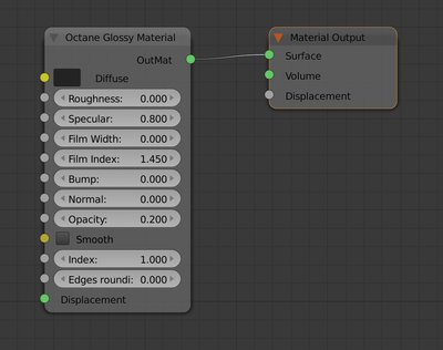

I may be wrong, but I think you can't make objects invisible for refraction. Maybe try replacing the specular shader with a glossy one (for this you'd need to make your glass planar). You may want to tweak those settings, eg. increase the Opacity to make reflections more visible, etc.Alain wrote:But if this Objects is behind windowsglass then it doesn't work anymore.
