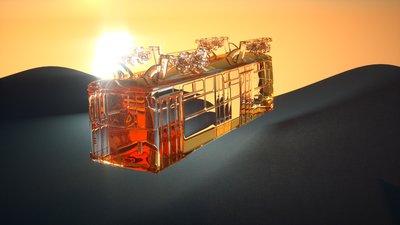

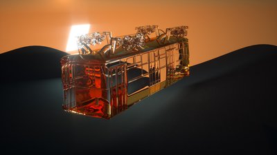

Oh well. My delighted with the new version will be more moderate. More precisely they will not be at all. To test scene I created a lot of glass, glare and bloom to notice the difference in lighting. Noticed. Picture 1.15 version much brighter. And if it was a difficult scene sunset I worked a year? Generally, it is blasphemy - to adapt the rendering so that the picture in all project changes, people can not sleep for hours diaphragm exposed, and they bang and all work is lost. It is not correct.
Now to the "rapture." The new version of Render longer (!) I do not believe it - rendered the twice rearranged version, but the result was repeated.
v 2.06: 3min 10sec:
v 1.15: 4min 02sec:
I am extremely dissatisfied with the fact that the picture became brighter. I thought of the dusty evening, and the new version was a nuclear fungus. Yes, I spent half a second is twisting the camera settings. But the fact that these efforts are offset by the new version is wrong. And even more so for a paid product.
