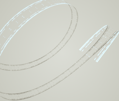

hi first thing sorry if this post before i search for same thing but i don't find anything anyway is there anyway make emission light coming from both polygon side in octane c4d ???
please take look to photo to understand and one more thing i know if i Reverse Normals will show the light in the other side what i want the both polygon side
thank you in advance

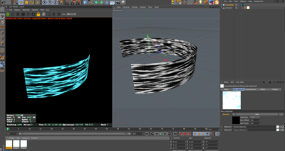

hi bepeg4d i try your mathilde but for some reason doesn't work with me :|
take look to the attach image

sorry, it seems to work well except with the emission node, since the emission is made always in the normal direction and ii's always black in the opposite side :(
anyway i have solved duplicating the mesh, inverted the normals and moved by 0.1cm the surface with the normal move command, hope it could work also for you ;)
