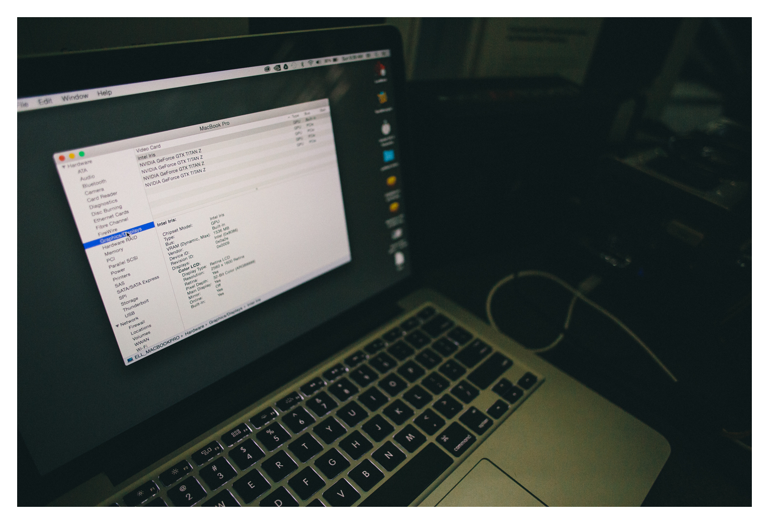

This video is great but the same process does not produce the same results on my 2014 MBPr w/ GT 750M + Titan Z. I am still getting the 1 Titan Z & 1 NVIDIA Web Driver in the System ReportJose wrote:Here is my Yosemite process for the GTX Titan Zgarytyler wrote:Thank you very much! I owe you one!
Good lock![]()
Link:
http://youtu.be/cPOB9qmPjaE
I am curious, if you visit the Extensions section in your System Report and view the info for NVDAStartup, What does it say? Can you post a screenshot of that? I am assuming it's acceptable for the driver to not be signed or loadable as long as it's status is Loaded: Yes. This is what the developer sudo command is for.
I'm installing a Boot Camp Win 8.1 now to test my card and make sure it is not faulty.
Also, I noticed the video at 9:12 has this title that refers to Mavericks. Is this a typo or am I missing something? Thanks again Jose!

Yes, Thank you. Is a typo.

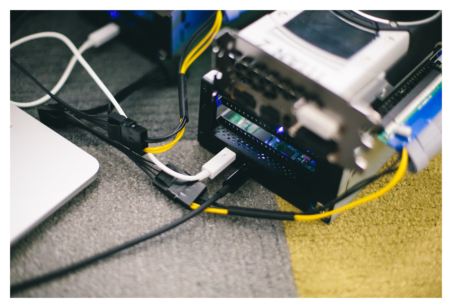

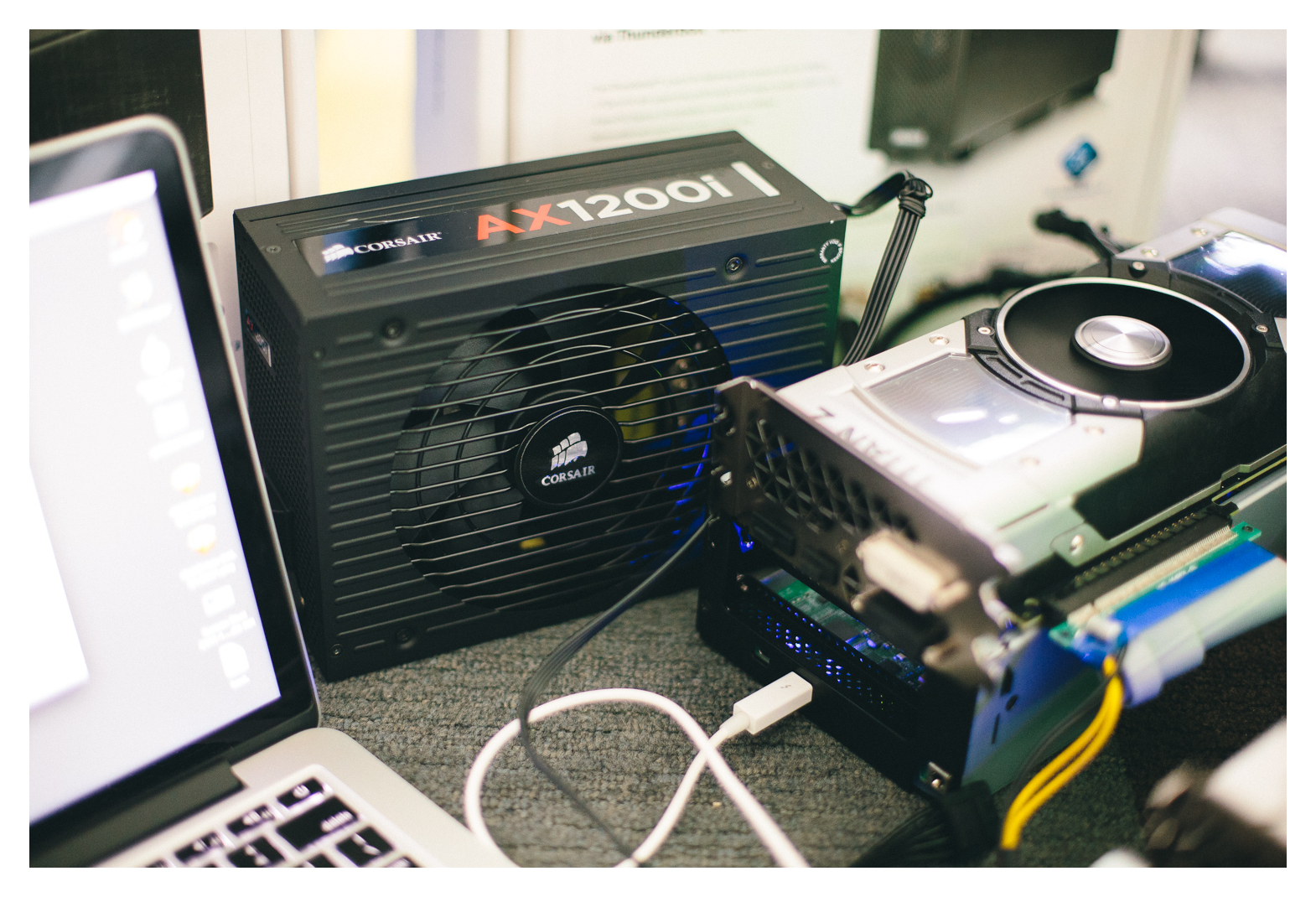

Are you using a riser or you connecting straight to the AKiTiO. I have your problem when I connect straight to the Akitio. Try the riser.

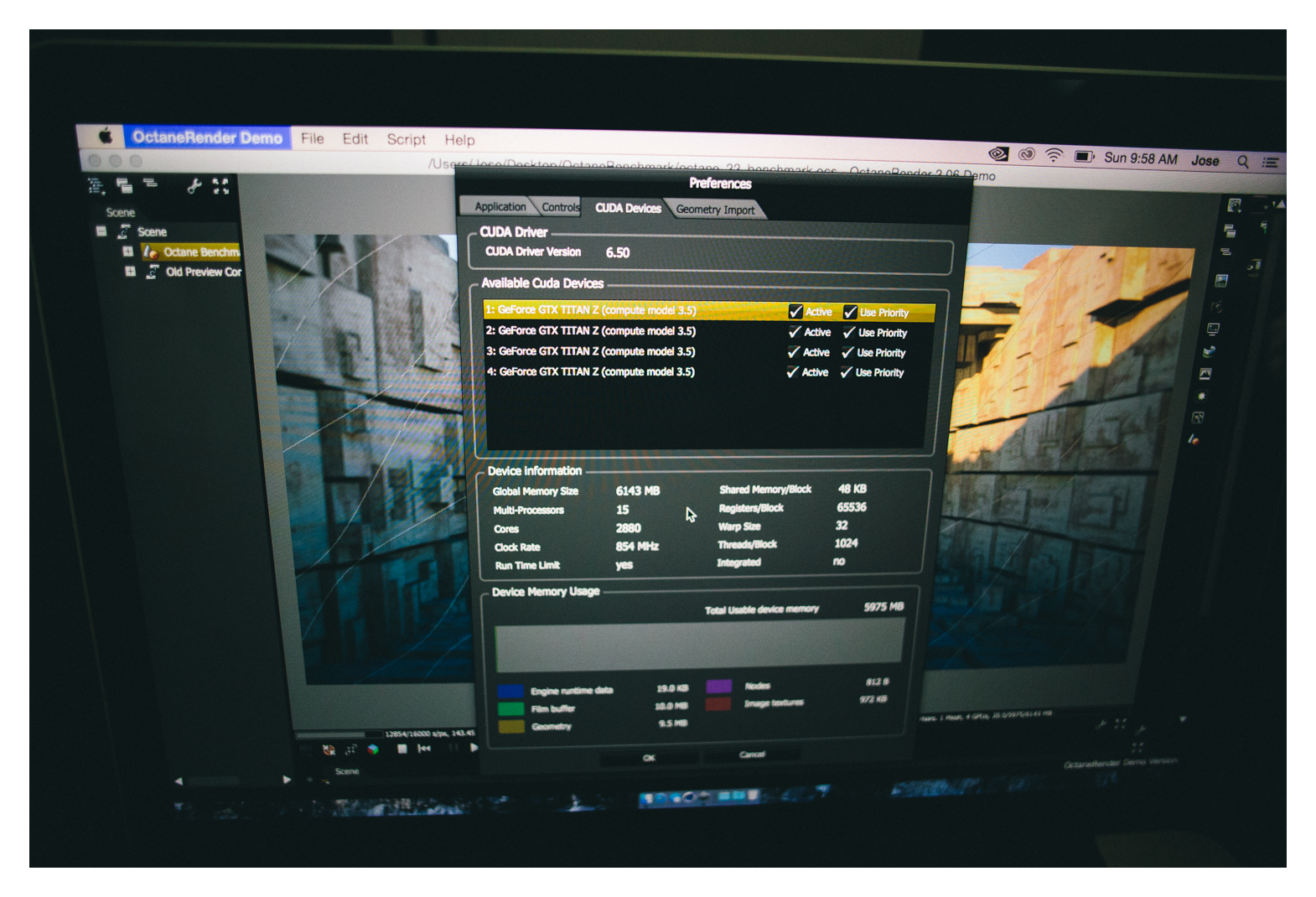

I just set up a Macbook pro mid 2013 with Thunderbolt 2 and I connect 2 Titan Z using thunderbolt daisy chain.
Mac Thunderbolt 1 can hold 1 TITAN Z
Mac Thunderbolt 2 can hold 2 TITAN Z
OS X Yosemite 10.10.3 | Macbook Pro | 16GB | 2 x Geforce GTX TITAN Z | Akitio eGPU | CINEMA 4D R16 |
Good to know. I actually tried it both ways. I have tried every configuration I can think of with what I have. I did notice your riser has the extra wires. Mine has 1 Yellow wire only. Might be helpful to post that link to the riser you're using on the video page because it is seeming like an important part of getting the Titan Z operating in full. For now, I went ahead and returned my Z and put in a reg Titan. I will be ordering one of those risers and seeing what I get. Thanks for the info man!

Riser Link:
http://www.ebay.com/itm/271448008328?_t ... EBIDX%3AIT
Macbook Pro mid 2013 with Thunderbolt 2 setup (2 Titan Z using thunderbolt daisy chain)
Two Titans Z setup and Benchmark Pics:
