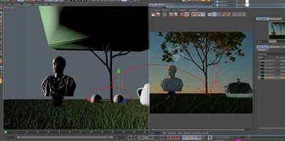

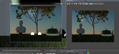

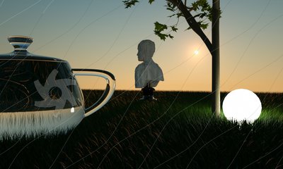

I did my first tests with Octane Render for C4D, and I was not able to reveal the texture light emmission. Is it necessary for it to activate a function in rendering parameters, or is it a bug.
I must say that my first impression is excellent.
I send you my screen captures
Thank you for your help.
Problem with the emission light
hi,
it's a known limitation.
just uncheck the 'render perfect' option in the attributes of the spheres objects
ciao beppe
ciao beppe
Nice. Also use direclighing with diffuse or pathtracing. 2.10 and newer versions are much faster on pathtracing with some helper parameters.
