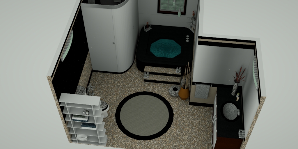

Another Archiviz scene from Google's 3DWarehouse. Rendered in the Daylight environment for a few minutes.
Archiviz scene from Google's 3DWarehouse. Exported from Sketchup via su2objmtl.rb and rendered in Octane. There are some material mismatches but those are minor. Transparency wasn't imported but I think I could easily play with it later to set it up like the original.
