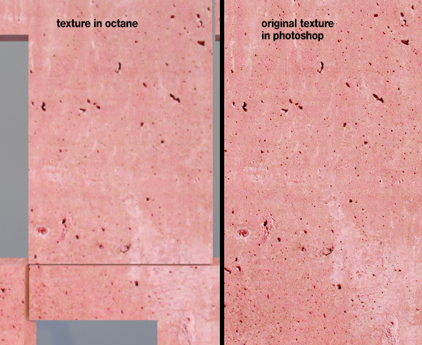

octane renders not sharp, even with filter size at 1.0??
waterthinking
Posts: 67
Joined: Fri May 28, 2010 8:27 am
well the title tells it all..made a test to show the problem
i think the difference is pretty obvious..
(render crop at 100%)
Octane 2.14
Render settings: PT, 6000 samples, filter size 1, aperture 0, other settings at default

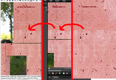

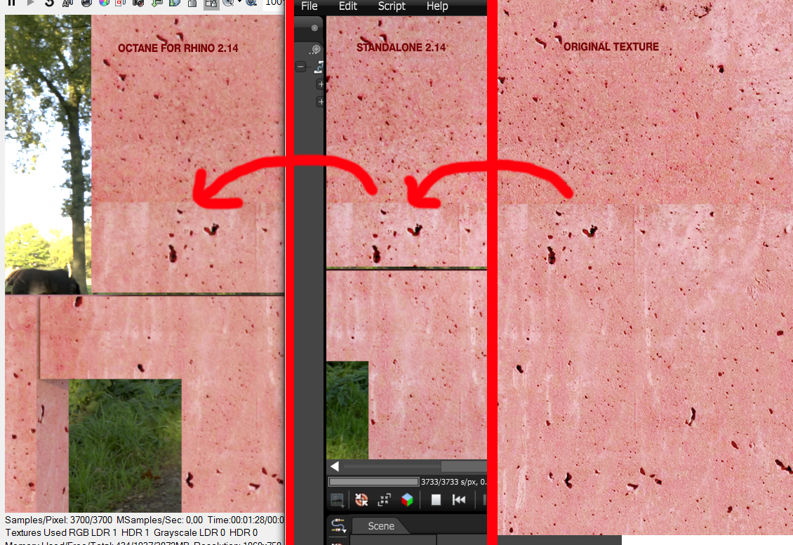

here you are a screenshot of viewports; the way i see it there is a progressive degradation
original texture > octane standalone > octane for rhino
how do you export a whole scene to orbx? (i thought only possible for materials)

to me it looks like a degradation in sharpness. scene only lit by an hdri. will test other setups..
Pls see the manual for details on how to export the OctaneRender for Rhino scene to Octane Standalone. http://render.otoy.com/manuals/Rhino/?page_id=31. Both Rhino Octane Viewport and Standalone Viewport should render identically when doing this. Your texturemap should appear exactly the same in both.
