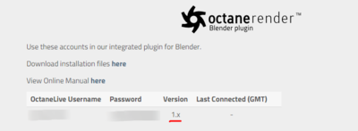

Ah! I discovered the issue. I purchased the upgrade in August that included a free upgrade for the Blender plugin:
For a limited
time, users who upgrade to OctaneRender™ v2.0 can also upgrade an existing
plugin license at no additional cost to make use of an available
OctaneRender™ v2.0 plugin or receive a voucher towards the v2.0 plugin when
it’s available.
I only have the v1 download available. How do I get the v2 version of the plugin?
rezman
Posts: 13
Joined: Tue Jul 20, 2010 5:19 pm
Sorry. Actually I have the correct download. But the license says v1.

Looks like you need to upgrade to version 2 of the plugin. If you upgraded to stand alone 2 a couple of months ago (I don't remember the exact date) you can get the plugin for free.
