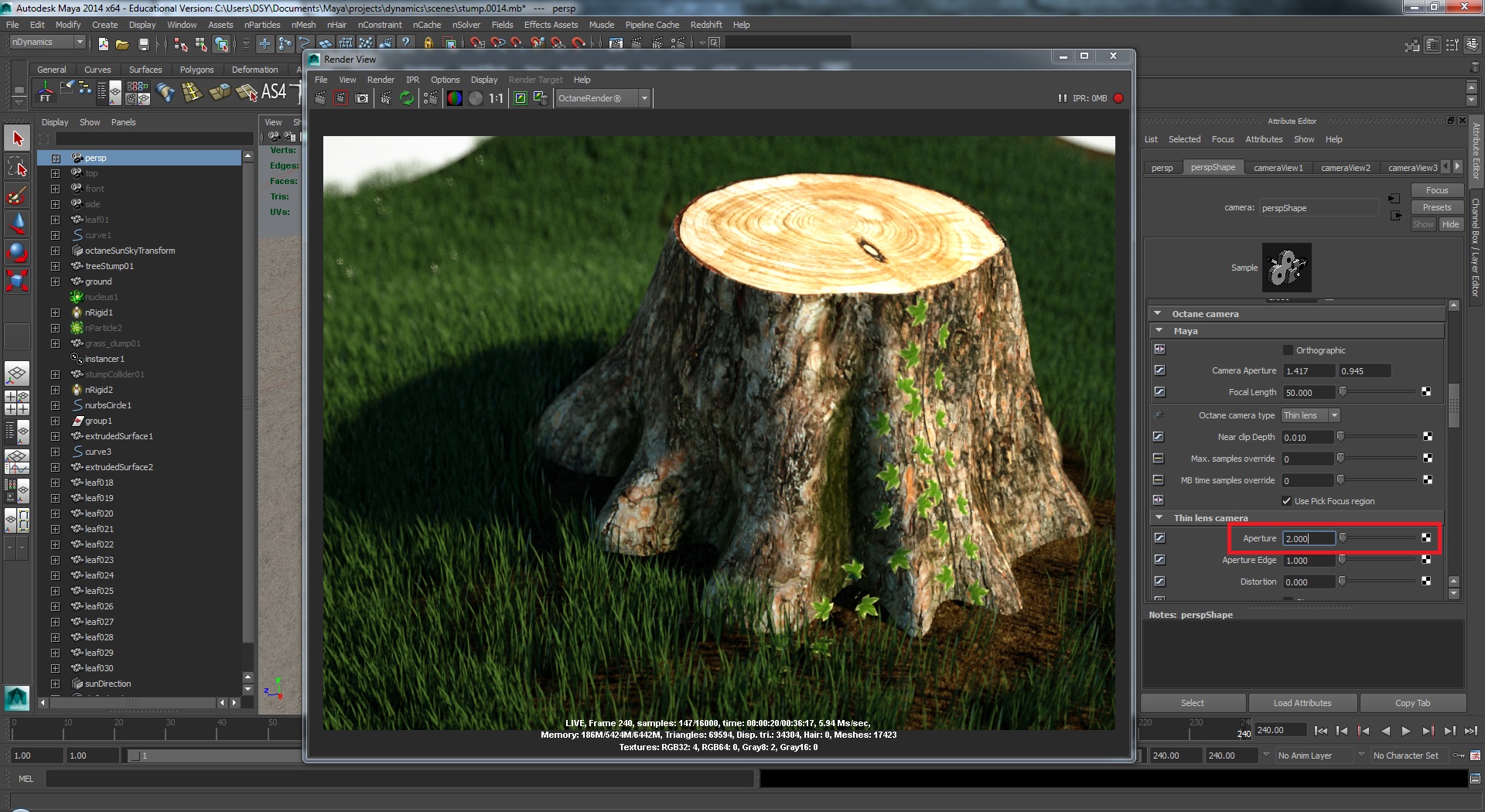

Camera shape node "Aperture" setting works for me...(see picture)

thanks man. I was doing that but it didn't seem to affect anything. maybe my scale is off or my scene is just acting funky or something. i'll do a new scene and double check everything. thanks

Oh, right...yes, Octane scale should be set to 0.01 if you work in Maya's default centimeter units. DOF will definitely be wrong if you don't.

thanks. looks like my scene was just acting up. i exported everything to a new scene and it worked fine.
