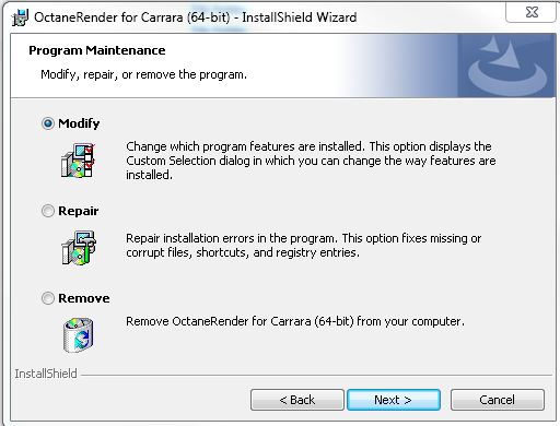

Having a bit of an issue, however discovered an error during investigation.
Once OC is installed, if you try to modify installation using the setup function there are no options in the modify option, therefore there is no easy way to test with different version of Carrara without manually copying the files.
If you want to install a previous version you need to uninstall the current version. If you want to restore the currently installed version use repair, not modify.

Correct, however modify is showing blank. This was more to bring it to your attention than to complain.Sighman wrote:If you want to install a previous version you need to uninstall the current version. If you want to restore the currently installed version use repair, not modify.
So to test OC in a different version like public beta I would have to uninstall from non-beta ? just curious
There are no options in the installer. I don't even know why it has a modify dialog. I'll see if I can remove it. As far as versions are concerned there is no difference between a test/stable/release version. It is simply based on the version number. You can upgrade from a lower version or repair the current version. But to downgrade you must uninstall first. It is no more complicated than that.
Edit: If you are talking about different versions of Carrara then that is different. You can only install to one version of Carrara. You then need to copy the Plugin files to other versions of Carrara. Pick one as your primary for the installer and then copy the files for other versions.
