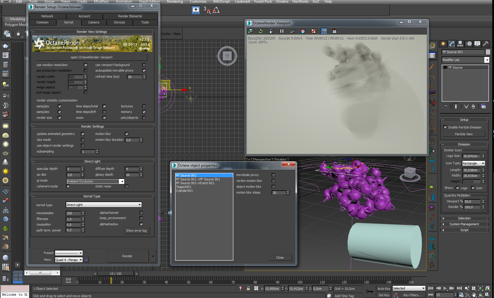

oguzbir wrote:Here is my report regarding motion blur.(MB)
MB steps, MB duration, MB checkbox, does not update until you move the time slider.
If I try MB with Particle flow. (Tested with geometry with particle flow box object shape and shape instance a teapot)
MB I think works but the samples are stuck 1 and oct. viewport repeat the first sample only with loop.
(tested using one and multi gpu's)
IF partcile flow elements like;
PF Source 001
PF Source 001 -> PF Source 001
PF Source 001 -> Event 001
Are set at object motion blur. Blur doesnt work.
Vertex motion blur works in some cases but only with final render. not octane viewport.
There is a lot of possibilities to test but all I can say atthemoment is that.
It doesnt work properly.
Karba here is a basic test scene an max 2014 format.
The attachment testMB_max2014.rar is no longer available
i try your scene and tweak it a bit and it works for me. You just have to set pf event to movable proxy and vertex motion blur and it works in realtime viewport. I try it in 3ds max 2015. However i get a very long time of loading to update each frame and a 100% CPU load ...

PF motion blur is working great for me in 2015. Good stuff, thx Karba.
oguzbir
Posts: 715
Joined: Fri Jun 25, 2010 12:30 am
Do you all achieve MB in Particle Flow using vertex blur or object blur.
Vertex blur sometimes works with me. But it's painfuly slow.
Shouldn't it be right to work with object blur?
What would your advice be Karba? I must use vertex blur for PF?
