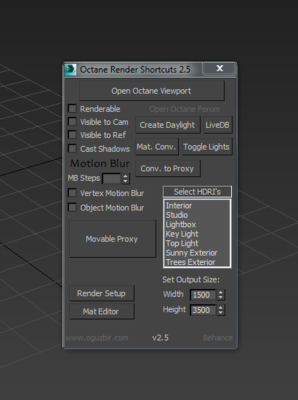

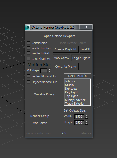

oguzbir
Posts: 715
Joined: Fri Jun 25, 2010 12:30 am
acc24ex,
I gave it a go and updated the script. Haven't completed yet. I'll upload latest version once I finish.
Also It would be good see people's interest. :)
As you can see I replaced the HDRI button with a listbox.
I updated Scene_Hdri.mat with the 7 hdri's I use most.
When I doubleclick on say, Lightbox. It grabs the 3rd material from the temp library.
And assigns to environment map.
Also creates a compass and wires the rotation with hdri's transform.
I updated the parameter wiring expression so that it rotates rather more nicely.
Added few render setup and mat editor button along with render output size inputs.
it's kindda like will fit my needs at this point.
This library thing works great. I'm thinking of expanding it to materials.
So I can get one click car-paint, skin shader, chrome on the go.
Will work on that soon.
Cheers,
