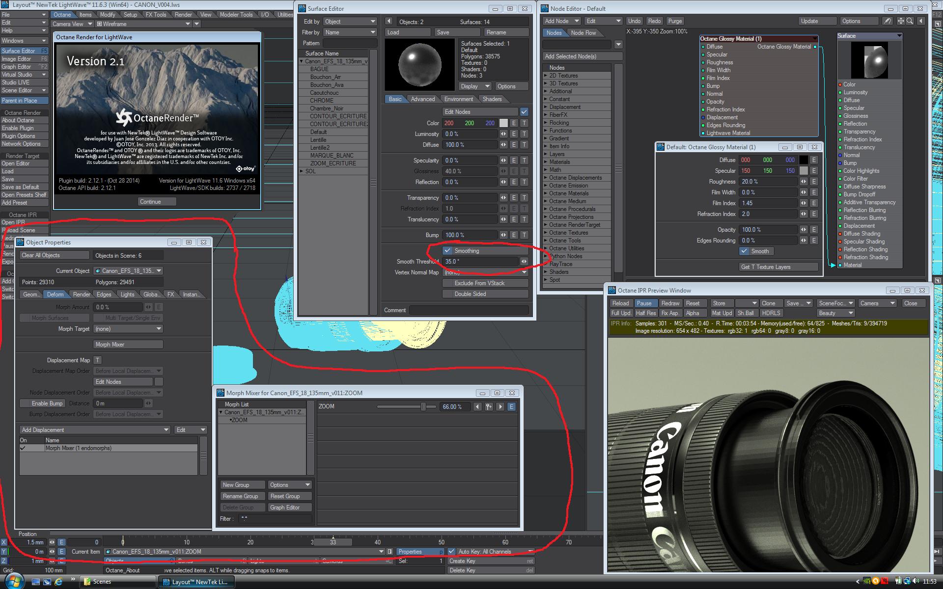

hello,
Smoothing problem with an activated morph, when disabled all function well.
Thank you.

EBD3D
Posts: 31
Joined: Fri Oct 10, 2014 8:58 pm
Only in IPR even if "reload" the scene after ajust the morph, f9 works well.
This is not a problem too, but IPR is also useful in the work.
Thank you Juanjgon ;)

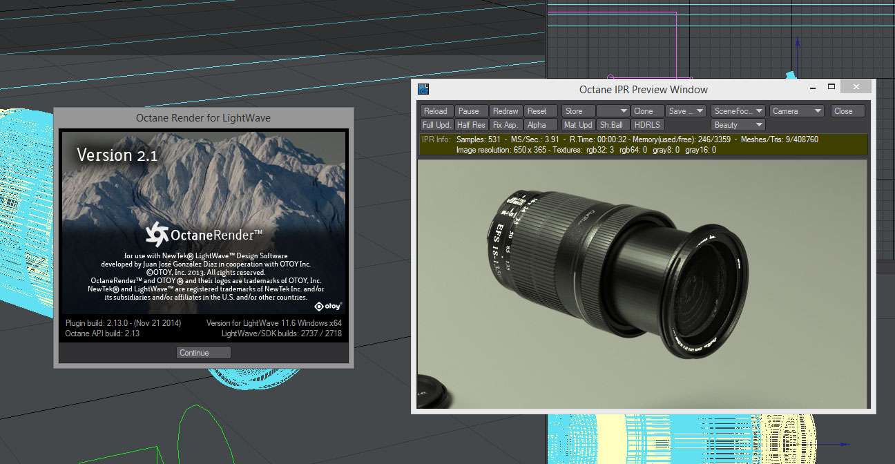

EBD3D
Posts: 31
Bonjour Juanjgon,
Nothing has changed.
Works as before, F9 then make it work in the IPR
Sorry ;)
