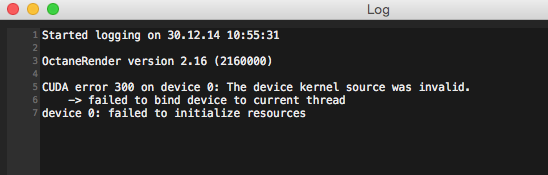

martincarlson
Posts: 319
Joined: Mon Nov 03, 2014 10:18 am
Location: Sweden
Updated CUDA driver. Log tells me this.
Martin Carlson, Visual and Audial Designer at Katzenwaffe Creative Studio | www.katzenwaffe.se | Soundcloud | Twitter
Intel Core i7-5930K / ASUS X99-E WS / 2 x EVGA GeForce GTX TITAN X 12GB / 32 GB RAM / Windows 10 / C4D R16 / Octane Standalone 3.03.3 / OctaneC4D 3.03.3-R1

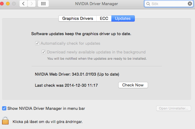

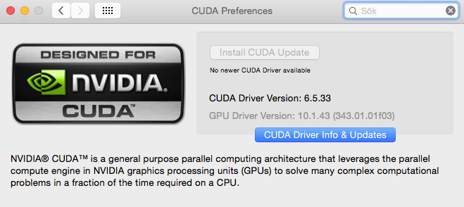

abstrax
Posts: 5514
martincarlson wrote:
Which CUDA driver did you install? Please post a screenshot of the CUDA device preferences of the Standalone so we can have a look at your setup. Thanks.

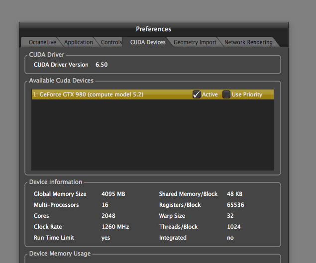

martincarlson
Posts: 319
Location: Sweden
