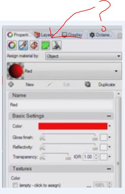

I have no materials tab inside my octane tab as illustrated below?
I'd also like to know how you added the materials tool to the properties window?
No Materials Tab?

Hi Mugz,
The materials are not found within the Octane tab. They are a separate tab. In your image the materials tab is to the right of the Octane tab. When you create a new material you will have the option to create it as an Octane material. Select Octane Material and you will have all of the Octane materials settings. See image below.
Also, you already have a materials icon in the properties window, see second image below. I'm not sure what your question is here. Can you clarify?

Open the Rhino Materials tab in order to access the Octane materials.
