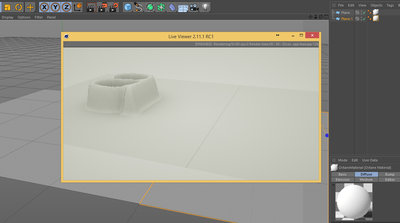

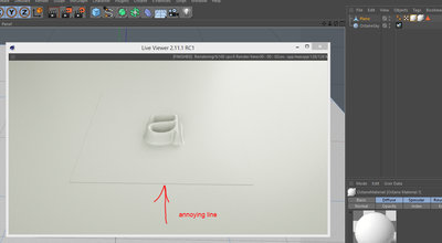

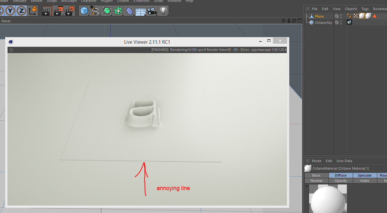

i am using 2.11.1 rc1
it seems that i cant switch off tiling from dispalcemet
and if i confine the displaced material with a polygon selection tag an annoying line appears
is there a way to fix this problem? THX

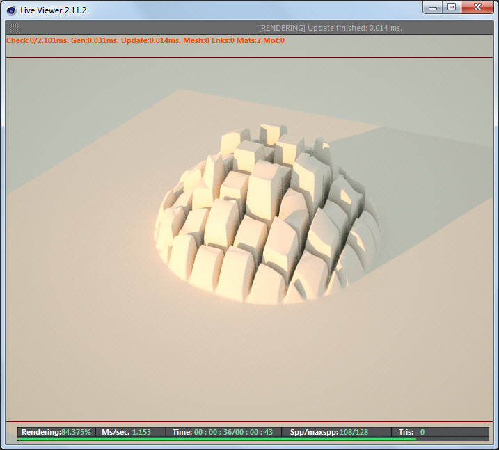

what do you see when you try this scene?
disp.zip
(112.36 KiB) Downloaded 205 times

i don't have problems with your file, i have problems when i use image texture.
the other problem i have is that the displace is always tiling, how can i avoid that?
Posts: 16068
Location: Türkiye
theoretically my sample and your scene is same. you should know c4d shaders are converted to images. only difference is color depth between two sample. so float images is looking better. also any settings of image does not seems as working.
all of these issues which are not related with plugin

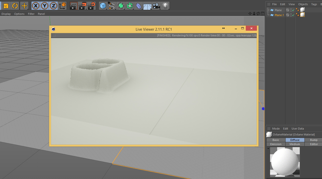

pls try to check this scene. two planes side by side one with displacement the other not.
disp problem.zip
(87.86 KiB) Downloaded 238 times
Posts: 16068
Location: Türkiye
is not clear my last message? I mean that should try 16 or 32 bit images
turtles123
Posts: 85
Joined: Tue Feb 18, 2014 4:06 pm
ok thx 16 bit maps solve the problem
