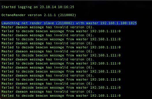

Network rendering DOES work as expected but we are getting and error in the daemon console continually looking for the IP address of a computer with no daemon installed (previously uninstalled).
Sorry if this is confusing. Please ask questions for clarification.

I don't think you need the daemon installed to be a master.
or maybe I am misunderstanding you.
The master that has the problem, is it connected to any computers in the network panel?

What you see here is that some older or newer master is trying to contact your daemon. With the next release these error messages will be hidden and only shown when the "daemon" log flag is enabled.
Of course, daemon, slave and master need to be of the same version everywhere in the network, to make network rendering work.
