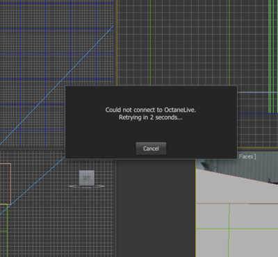

I can't open the LiveDB to access the material there. It was like that a month ago, it is like that now.
I remember having the same problem more than a year ago but for the life of me I can't remember how it got solved.
I am using 3DS Max 2014 and Octane plugin for 3DS Max 1.55b. My Internet connection seems to be working just fine.
Sorry if that has been discussed before but searching for "Can't access to liveDB" gave very vague results.
Thanks for any help.

Thank you kindly for your response. The error message is "Can't access to liveDB" in a small dialog box.
I don't have any firewall active nor do I have an Antivirus (these are one of the first things I turned off in my Windows 8.1 Pro).
As for live1.refractivesoftware.com on port 443 (https)- not sure at all what it means, how can I check if me or 3DS Max can access it? Is it done through a web- browser or Command Prompt?

						That error is normal for our server.
This means your machine definitely has access to the LiveDB server.
So either something is blocking 3ds max in particular, or some other strange problem is happening.
You could try clearing your LiveDB cache (found in c:\users\[username]\AppData\Local\OctaneRender\cache).
