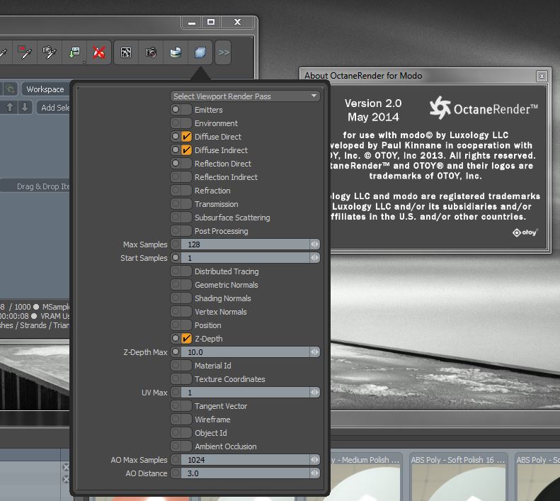

I've just install V 2.11 and... I think i'm gonna get crazy! the "about Octane..." says I m using v2.0 an I don't have the same window for render passes than in the manual. See image below and the link to the manual
http://render.otoy.com/manuals/Modo/?page_id=1058

Hi Simsen - render passes are changing with each Octane release at the moment - but once they are finalised I will update the manual to reflect the actual passes. Until then the screenshots in the manual and the plugin may not exactly match. And I will change the "About" bitmap to read "Octane 2" rather than "Octane 2.0". You can see the actual plugin version number at the bottom of the Setup panel, and in the Modo->System->Kit Toggle Enable menu.

Ok, now I know what version i have ( the latest) but i still haven't found how to render passes... I gave a value of 1 in " start sample" in the render passes panel but nothing changed... Where Am I wrong?

Hi Simsen. Tick the render pass(es) you want to render in the Render Passes panel, then choose the render pass you want displayed in the Viewport from the "Select Viewport Render Pass" dropdown box.
