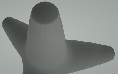

OK, here's the same object with an image environment - better, but not perfect.radiance wrote: that's maybe self-shadowing, can you try with an image enrivonment instead of the daylight systen environment ?

Thanks for bearing with me.
I think I'll just wait and see what becomes of Octane in the future.
Right now the advantages of the real-time rendering are diminished by the workflow for me.

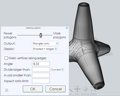

Hi Kaspar, for this model you could try 'divide larger than' in the export meshing options.
This way it would ease off those long narrow triangles.
Marc
