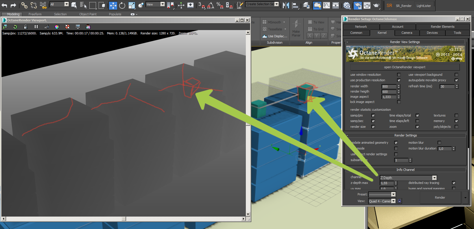

Zdepth - specular material
sorry, but what's the problem here? =)

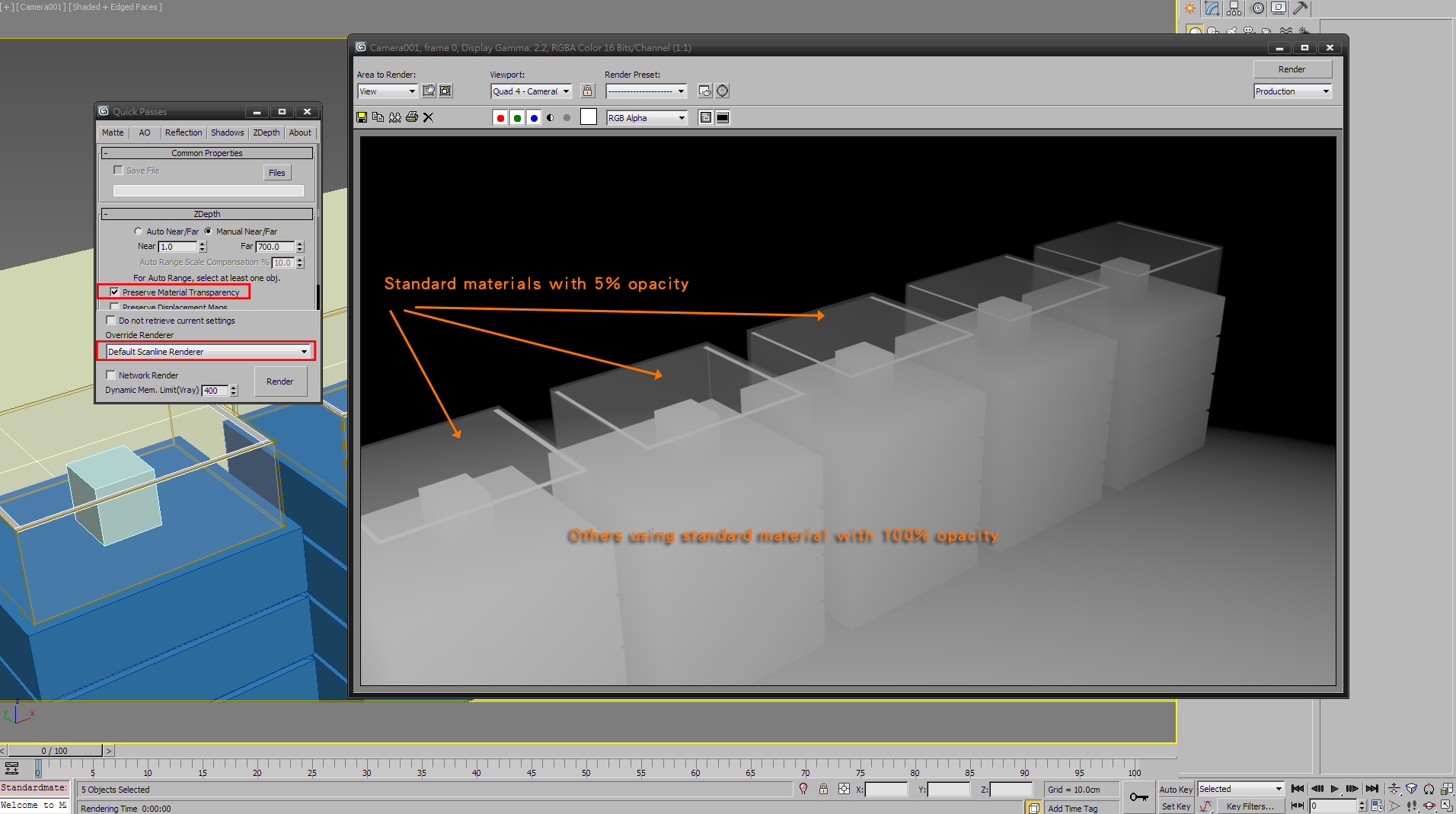

Hi
You can try Tik Quick Passes, it's a free macro script: http://www.scriptspot.com/3ds-max/scripts/quick-passes
And render using scanline or mental ray with standard materials.
still needs ps to invert the result anyways

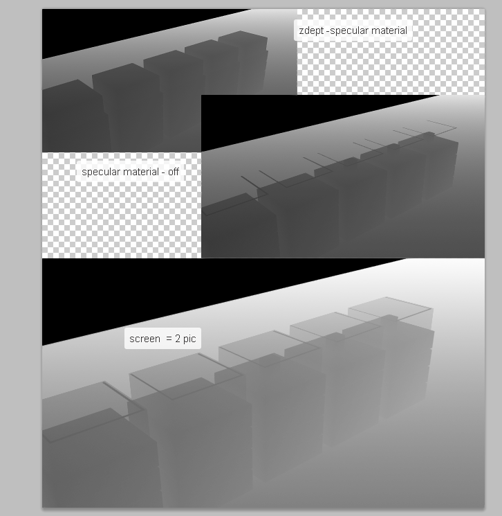

& it shloudn't, cos it is based on geometryGoldisart wrote:glimpse wrote:sorry, but what's the problem here? =)
standard zdepth does not work inside the glass
(it doesn't take reflectivity & reflectivity into account)

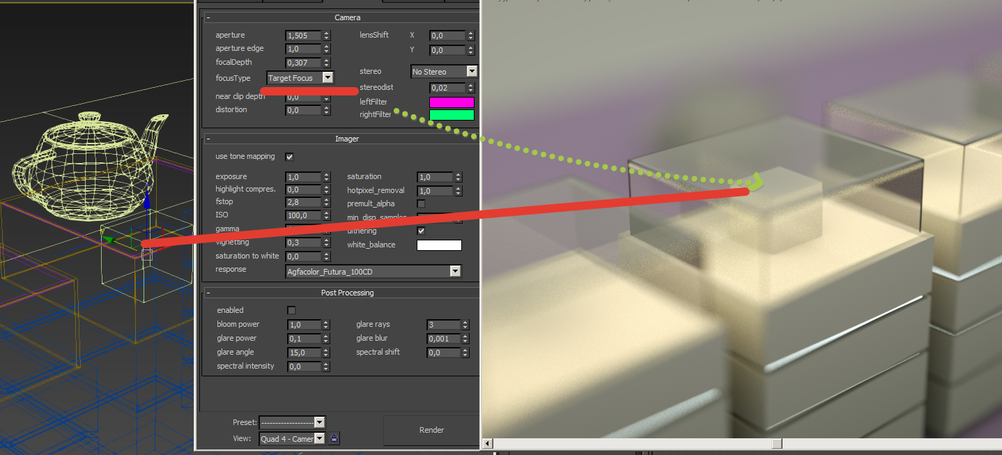

if You want proper depth use in camera inside OR =)
