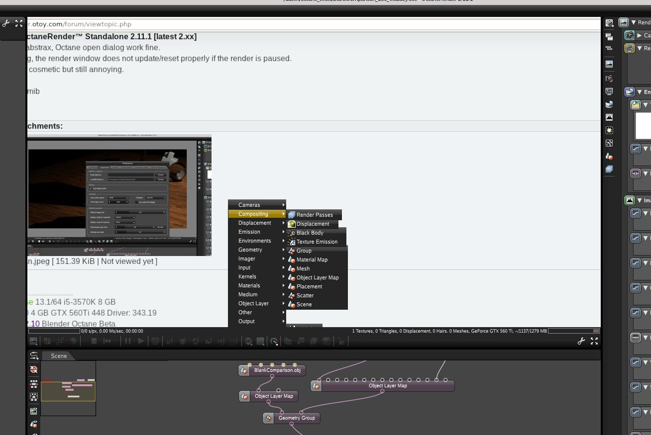

This is a now issue on Linux with our gui toolkit. You can work around it by switching to the software viewport in the application preferences.mib2berlin wrote:Thanks abstrax, Octane open dialog work fine.
One thing, the render window does not update/reset properly if the render is paused.
I is more cosmetic but still annoying.
Cheers, mib

Thank you stratified, software mode work fine.
