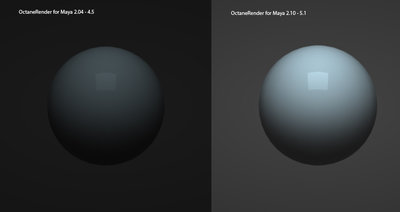

So I was re rendering some shots i'm working on with the new motion blur (witch is awesome) and i notice some kind of exposure difference between the 2.04 and the 2.1 version of the plugin. I could reproduce that just with a sphere, one light and one env. (see image)
For now I can color correct in comp to match my old render but I was wondering if it was expected or maybe something i'm missing
Ben
