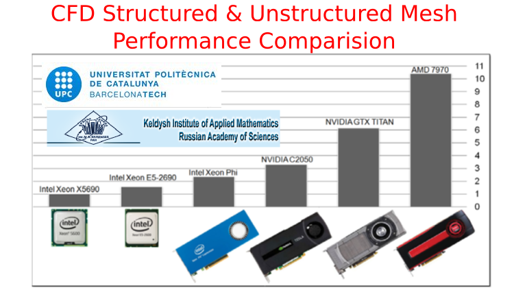

p.s. there's a reason why fastest computers on the planet use GPU accelerators in order to speed up calculations... think I've seen a good image to illustrate this point (it might be skewed, as performance is judged on certain metric, but You get the point..GPUs are on entirely different level of performance compared to any CPU =)
https://twitter.com/tomglimps/status/49 ... 04/photo/1
