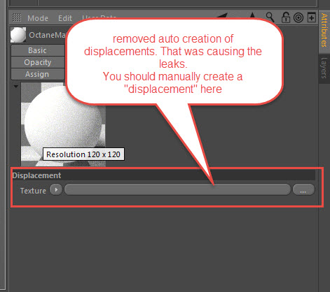

Description is on image. regarding the objectag, what kind of object is that?
Naturally I tried loading an image. I get nothing. I can't load an image texture or just load an image. It just doesn't work.
alec
couldn't describe well in image? Create a "Displacement" node. Then create a image in this node
