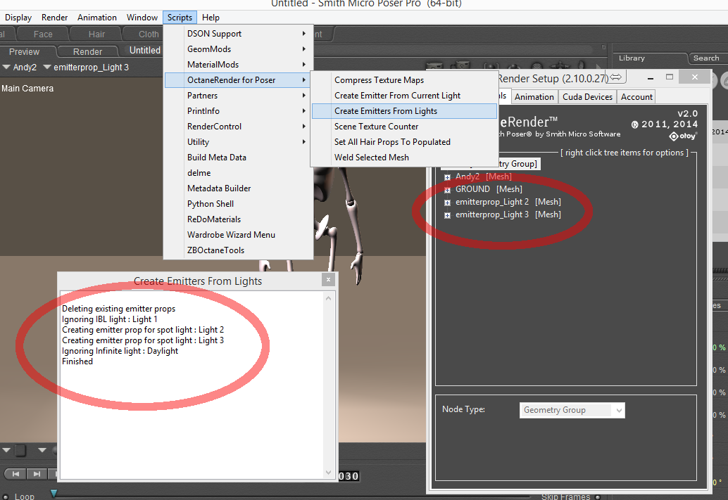

Hi - the following screen shows the result of running the Create Emitters from Lights script on the default Andy startup scene. If you are getting a different result - can you post a screenshot pls.
Paul

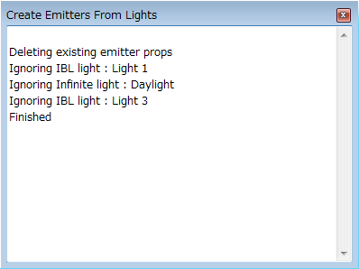

I found that existing lighting was "ignored" for unknown reason (see attached image).
octaneplugin.log is also attached.

Only spot lights and point lights are converted to emitters. IBL lights are ignored (since the IBL texturemap will be in the Octane texture environment), and Infinite lights are ignored, because the first infinite light in the scene translates to the Octane Sun.
