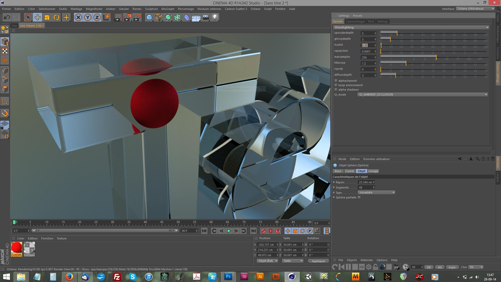

Hi guys,
I'm testing C4D r15 plugin trying a quick test with a glass material and some object inside a text object.
The spheres inside the glass material should be red. Which works fine if I hide the glass material.
How can I fix that?
Thanks!
Screen Shot 2014-09-27 at 20.14.19.png (73.15 KiB) Viewed 1734 times

are you working on directlight kernel or pathtracing - also number of glossy and specular levels should be above 6 or something, also number of bounces should be enough, more than 5-6 I think there is no bouncing of light there

Cool, changed the algorithm to Pathtracing and it worked fine.

I think you were in Directlighting > GI_Ambient_occlusion. It works too in this case with default kernel parameters but you need to reduce the AOdist.
It will work without special parameters in Directlighting > GI_Diffuse but of course, as said acc24ex, if you have multiple objects with specular material seen by transparancy, you need to increase specular parameter.
AODist set to 0.35
AODist set to 0.35
