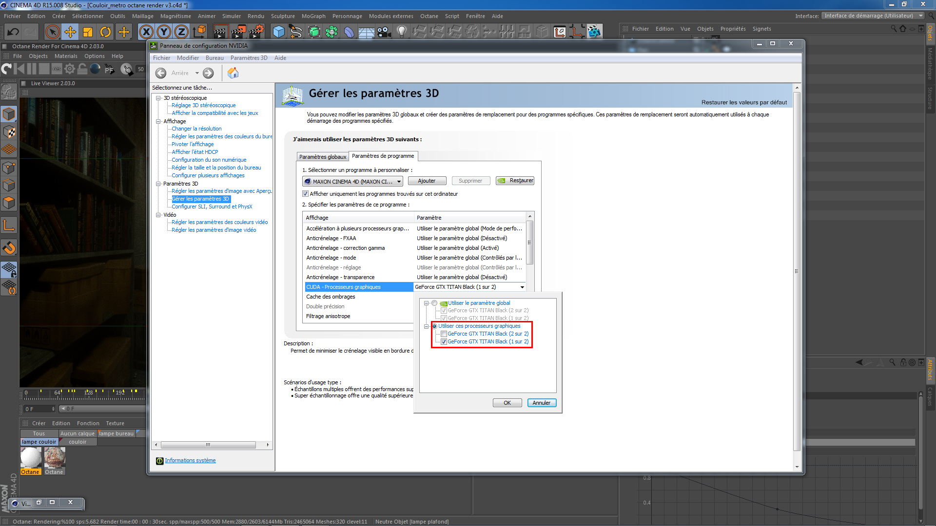

I find a solution to my problem but it's very weird. In MY NVIDIA CONFIGURE PANNEL, i have disabled one of the two graphics card for cinema4d application. (picture 1)
