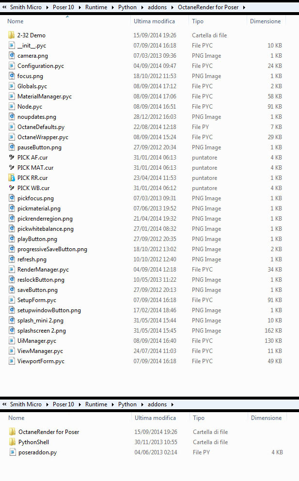

when i start poser installed plugin (x86) it ask the path "C:\Program Files (x86)\Smith Micro\Poser Pro 2014" ... and no poser 10
anyway i search poser 10 folder and install there .. C:\Program Files (x86)\Smith Micro\Poser10
OctaneRender for Poser folder is there but poser dont load the plugin ..
no octaneplugin.log file there

Hi - if there is no octaneplugin.log file, then I doubt the plugin was installed.
1) What plugins are listed under Poser->Window->Addons
2) Can you pls post a screenshot of your C:\Program Files (x86)\Smith Micro\Poser10\Runtime\Python\addons\OctaneRender for Poser folder.
Paul

Andygraph3D
Posts: 268
Joined: Wed Mar 20, 2013 7:25 pm
the screenshots ..
face_off
Posts: 15715
Location: Adelaide, Australia
Thanks Andygraph3D
Everything looks correct.
Paul
