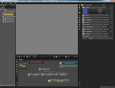

Hi and thanks for interest,
I've opened the chess_set_imagemaps.ocs from demosuite
I tried upon your advice to add Diffuse material in Graph Editor (but with no link to other items)
Selecting the item in the graph editor makes some description fields appear in the Node inspector. I can change them, but no image appear in the render Viewport.
Please see a screenshot as attachment .
Thanks again.
Thanks again.
