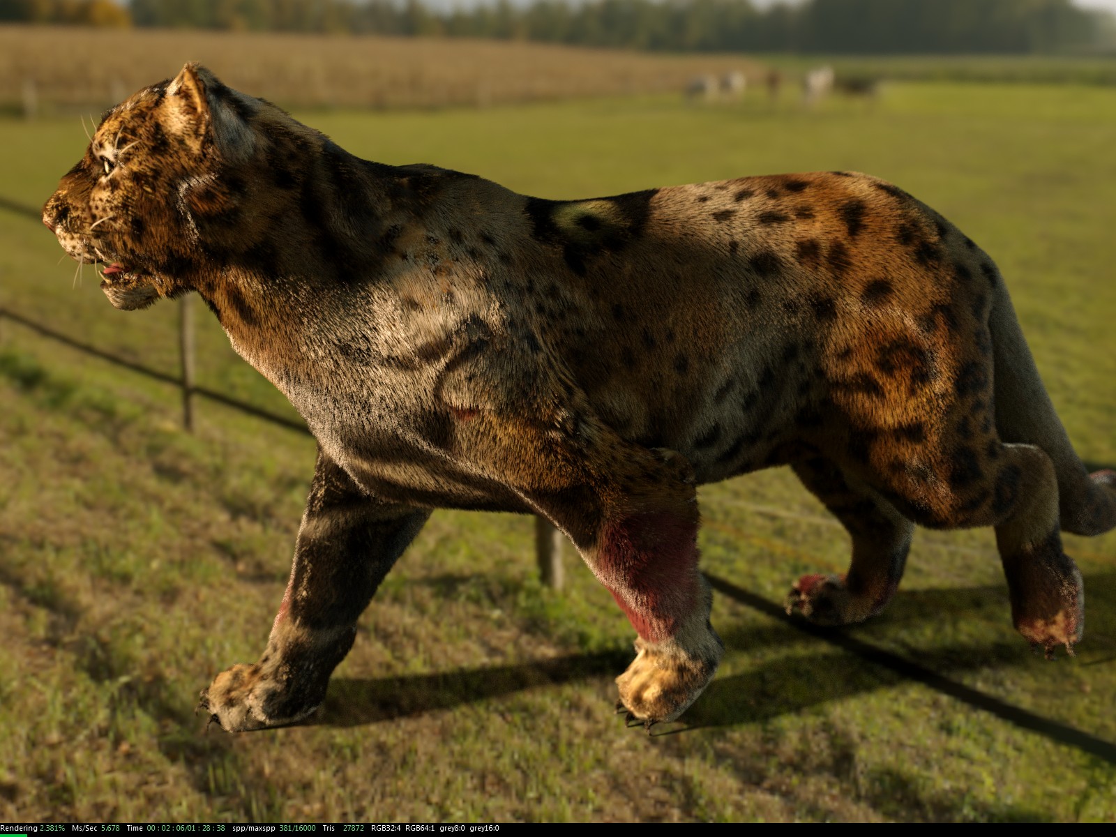

Hi all,
because of some user question about hair usage, i have done a quick sample. That's not perfect but ok. I hope that helps.

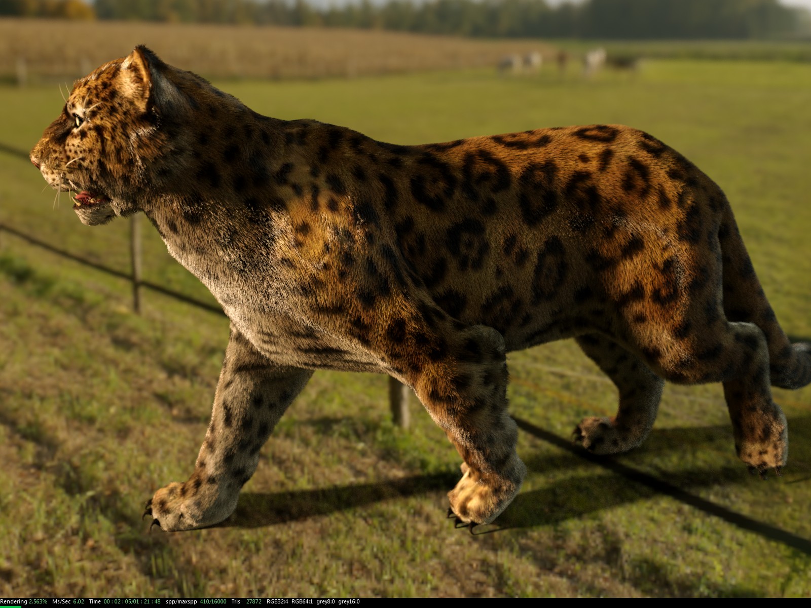

Hi all,
sadly i have to say that found a bug on hair uvs. That's looking reverse for Picture Viewer rendering. After fixing, previous render is looking like that.

Hi all,
