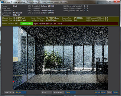

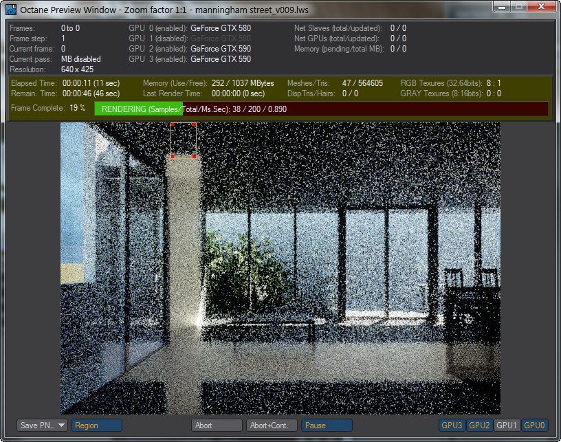

I've noticed the same. The progress bar moves at normal speed but the ms/sec drop way down and it actually seems like it's not rendering at all. More weirdness though.. if the render region touches one of the borders I get a horizontal or vertical band being rendered. See my screenshot below:
horizontal band
vertical band
